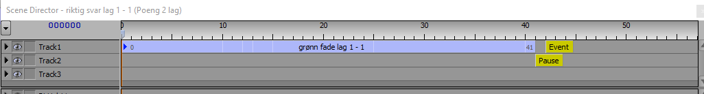

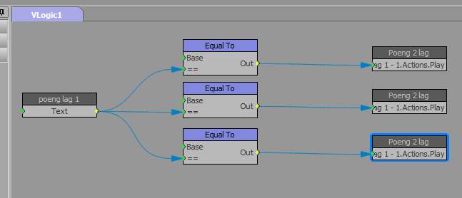

    I want to make a scene where when I change the value, a scene director is played. I managed to make this work when changing the value once but not multiple times. Any way to make this work as many times as I want?
    Link to video of the problem in the scene: https://www.jottacloud.com/p/hermangud/08ce2fb202954de7839f04e59be88f57
  • 2.  RE: Make Scene Director play again after value change
    Posted 03-19-2017 23:06
    You need to stop the other scene directors from playing. You can do that by adding an event in the scene director itself, or by using the stop command via visual logic.
    EDIT: I just noticed you're only using one scene director. You'll need to work out how to stop it before running it again, I would think.
