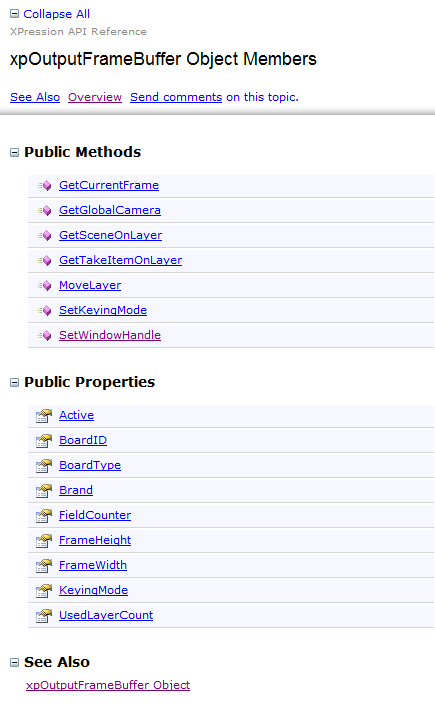

    What event is that? No members of xpOutputFrameBuffer are Events:

    What version are you with ? There are 2 events that are [I]OnClear[/I] and [I]OnSceneState.[/I]

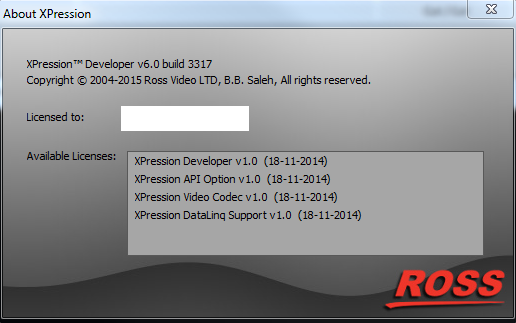

    This is what's in the About window in Ross XPression Developer:

    Since version 6.1 build 3406 :
    • [implemented] xpOutputFrameBuffer objects can now trigger the OnSceneState event when scene going on/offline
    • [implemented] xpOutputFrameBuffer objects can now trigger the OnClear event when the framebuffer is cleared
    I would recommend contacting techsupport@rossvideo.com.
