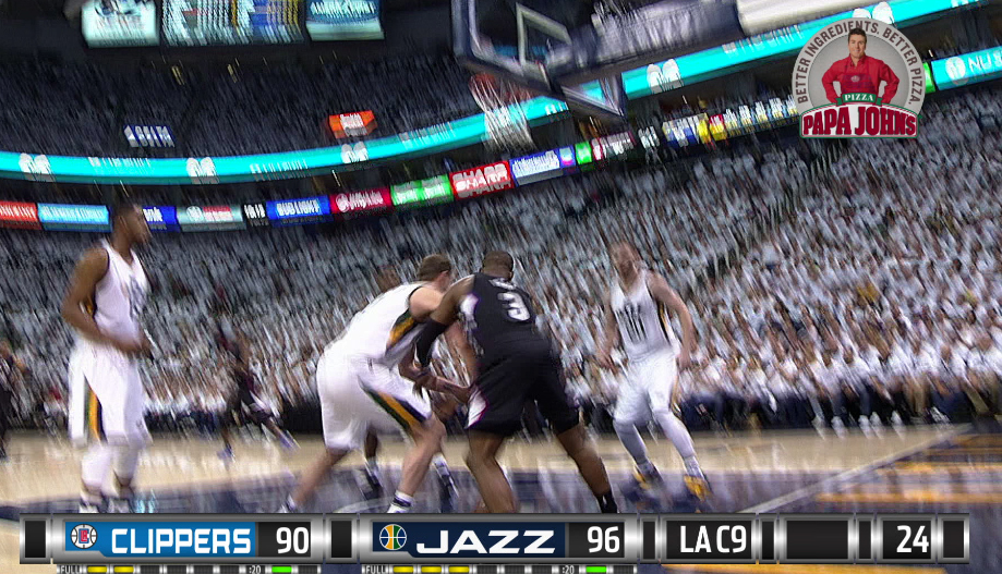

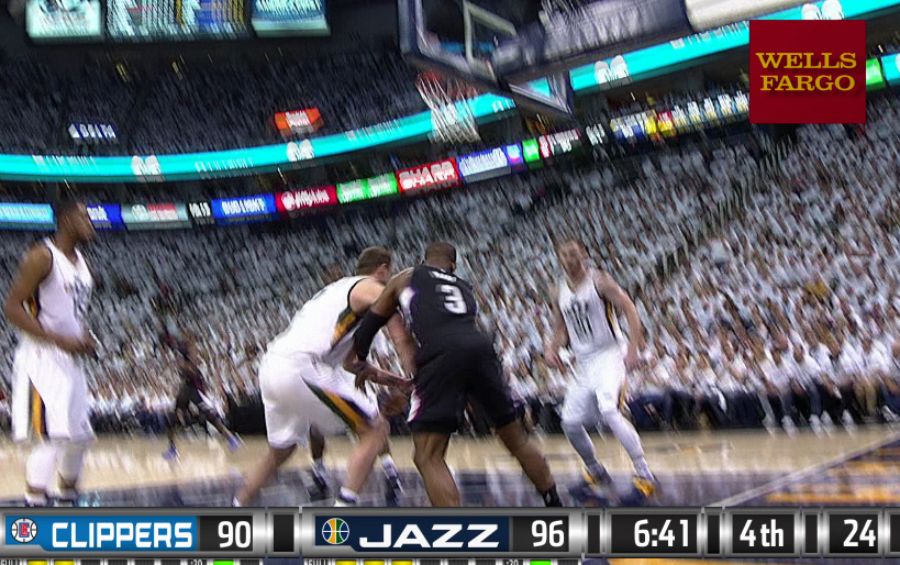

    We have noticed a problem with our data from OES as well. Our scoring system is a TISSOT system which is fed into a "black box" that converts to OES data. (Im not in that info loop) During time out, or foul shots when the timer is not running it will flash to LA C9 and the period field will go blank. I have attached two samples. Also, our replay bug in the upper right corner uses period data to replace the material. When the QTR field on the scorebar goes blank, the replay bug reverts to the default material. When the data is restored then the proper material is applied in the replay bug scene. These are different scenes, playing on different output channels. This doesn't happen every time the clock is stopped and doesn't happen in every game. We have just begun the trouble shooting process.
