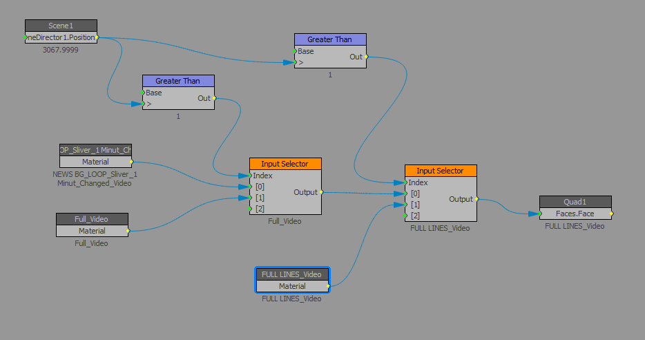

  • 5.  RE: Video materials: what am I missing?
    Posted 03-26-2019 16:56
    Hey, you can either keyframe it or if you don't need a fade or dissolve type effect you can use visual logic to trigger the texture to change within the same object instead of changing objects. This removes this issue and is also more efficient for the engine as well.
