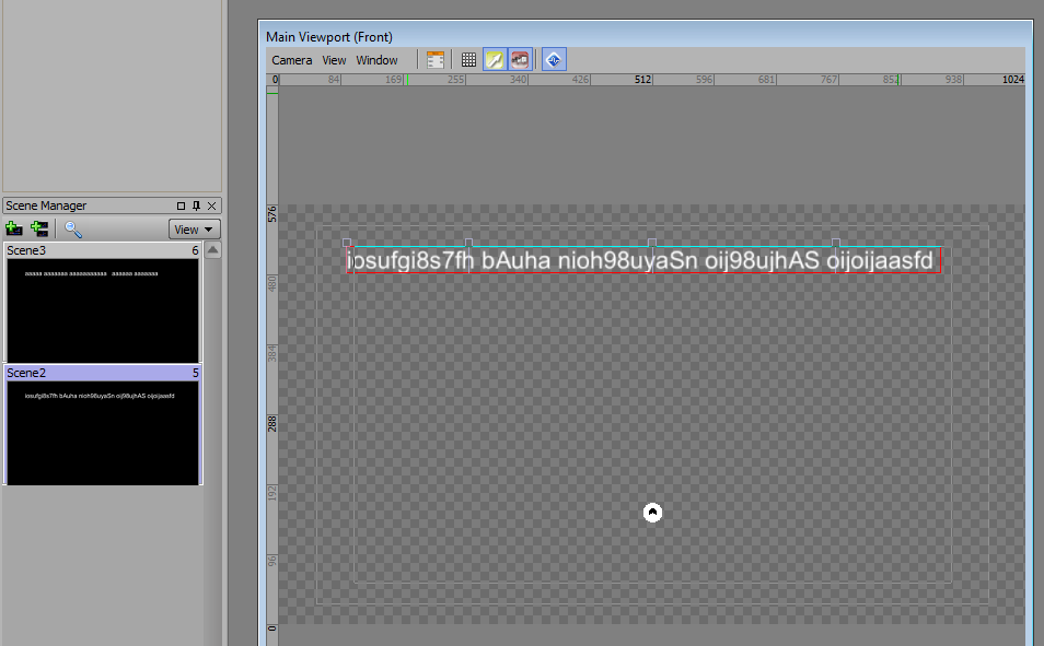

    1. Makes some scenes with static text in them. Maybe duplicate one for convenience.

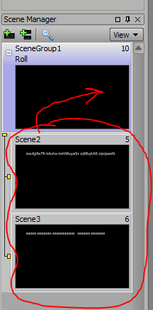

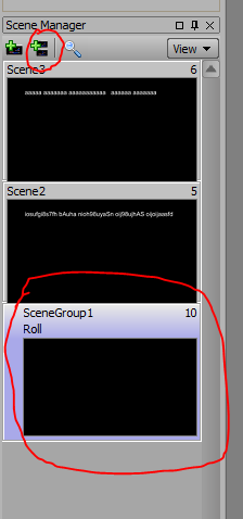

    2. Go to the Sequence and create a Scene Group in the Scene Manager. Drag the rigid text scenes into the Scene Group and you'll get an instant roll. NOTE: sometimes a Scene Group refuses to accept scenes. Delete it and make a new one.

    3. Click on the Scene Group once and go back to Layout. Make sure nothing is online in Sequence before you switch to Layout.

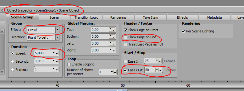

    4. Select Crawl or Roll over at the Scene Group tab at the Object Inspector. Set the speed. 5 is nice for crawls. Uncheck Blank Page on End if you want to create a Hold or Pause at the end with your station copyright or whatever. Set Ease Out to 50 frs to get a smooth stop.
