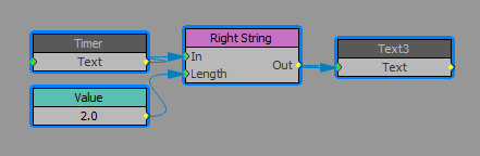

    I played with this in a very basic sense. I made a scene director that ran an animation (think of it as your QTR to PC). On the clock, I added a script: dim qtr as xpSceneDirector
    scene.GetSceneDirectorByName("QTRtoPC", qtr)
    if trim(text) = "40" then
    qtr.PlayRange(0,20)
    elseif trim(text) = "12" then
    qtr.PlayRange(20,0)
    end if
    To eliminate leading zeroes, etc, I also used a visual logic block that took the time and only looked for 40 & 12. And I applied the script to this new text field instead of the timer text field.
