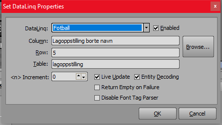

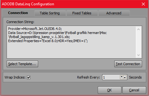

    "‹Every time I Close Xpression and re open it, all the values which uses Datalinq freezes to the value that was last received before I closed my Project. If I change the value from where the data is coming from, the value in Xpression stays the same. The only solution I find was to go into the value, click set on the data source, then just click OK without having to change any values. Then the Datalinq is live again and I can use it normally until I Close the program again. Since I have several hundreds of Datalinqs this would take a lot of time every time I open my Project just to re activate the Datalinqs. Posting some screenshots of my settings in the Datalinq.
    "‹PS. The values are not changeing in the layout but when I play out a scene in the sequencer, everthing is just fine.
