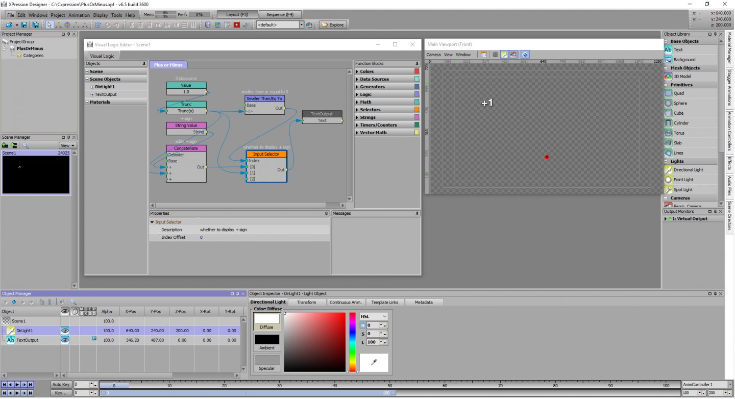

    Would this work? The plus/minus sign should follow the digits' justification.
  • 4.  RE: Adding a + to a positive number
    Posted 09-28-2017 15:39
    Yes! In my mind I knew I could link it to visibility of plus sign if greater than zero...but wasn't sure on making it follow justification. I will give that a shot. Thank you!
