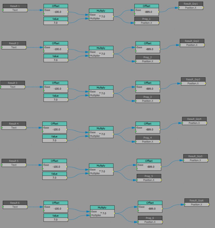

    Well, that's kind of what I built yesterday, although I used position instead of scale. My bars are oriented in X, and I have visible text fields in which one can enter the results. That number (with a multiplier of 7) determines the X Position of the bar, and a mask which animates the entire possible length subsequently reveals it. I have also made it so the result number lives at the end of the result bar, for a more dynamic look. It works, but what I really wanted was for he bars to grow, with the number following along the edge and have the displayed value climb from 0-X until it reaches the number input as the result. It would have better production value for sure, but I can't crack that nut.
    Here's a look at the logic setup:

    Yeah, I don't think there is a way to really use VL for something like that since the actual keyframing has to be dynamic according to what the values are. Probably have to look into scripting for this one. Sadly, I'm with you on my knowledge of scripting and wouldn't be the one to write out something for this. The only way it would really be possible is if there is an already set location for each visible percentage value (i.e. they all line up perfectly in a column). If you wanted their positions to be dependent on the size of the bar, then you'd have to rely on scripting.
