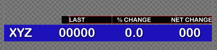

    Is there a way to have DataLinq tabs populate from just typing in a stock market symbol? In my example, I want producers to be able to type in a certain stock symbol (XYZ in the screen grab) and have the following tabs populate with corresponding values from our RSS DataLinq file.

    Just to understand correctly, you want only XYZ to populate Last, % Change and Net Change? And ABC might populate 3 separate categories?
    Just seeing these are set up as tabs, I would set them up as their own text field so you can better customize the field.
  • 3.  RE: Auto Follow DataLinq tabs
    Posted 11-11-2017 16:35
    That is correct. I want each stock to populate its own fields using datalinq. I do have each one set with different text fields, I was just using this as an example. Any thoughts?

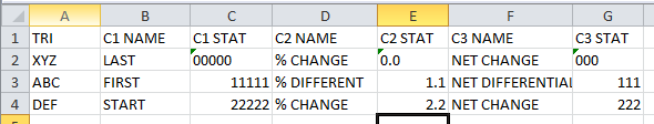

    Hmmm I don't know how the XML is set up, but you might be able to adapt this excel example.
    If you are able to cutstomize the xml, you could easily adapt the excel example.
    Sorry If this isn't much help
