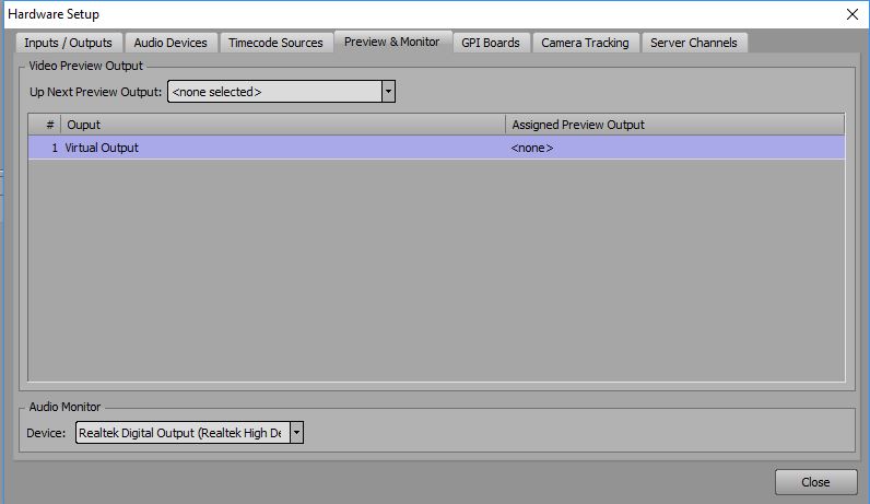

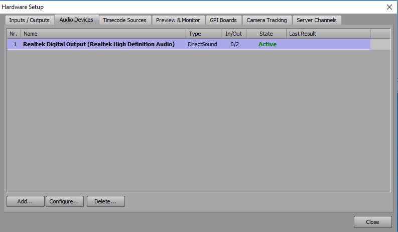

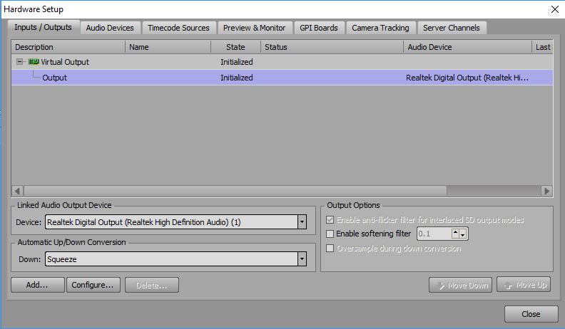

    Here is the setup as I have it - I was simply trying to listen through Headphones plugged into the Headphone Jack in the PC Tower. The 'Realtek' device you see here is what the system says I am using when listening through the headphones, and other audio files outside of XPression do work.
  • 7.  RE: Cannot hear audio
    Posted 03-20-2019 19:12
    You've got the *Digital* output selected. I have a Realtek audio at home (who doesn't?) and digital is specifically the optical out, which I use. You might need to re-add you audio device and use a different output (a.k.a. analog or headphone, etc.)
    Which is curious as I don't have an optical out on this machine, and the only options available to select were Realtek and my displays...

    If you have the Realtek HD Audio manager installed, the settings page (gear icon in top right) might have some options to play with (i.e. mute rear output when front headphone plugged in). If not, or if that doesn't fix it, you might want to re-install the audio drivers. It's weird it's only showing you digital when you only have analog outs.
    We have an XPression Quad with the inputs as follows. Oh, I love how the forum auto-rotates an already correct image... :{
    Edit: I was confusing 'digital' with 'optical' - you're correct they're not the same thing, but it's really 'speakers' you want that's not showing up.

    In case you haven't already tried this, you have to map each output to an audio device in Inputs/Outputs. This one just bit me!
