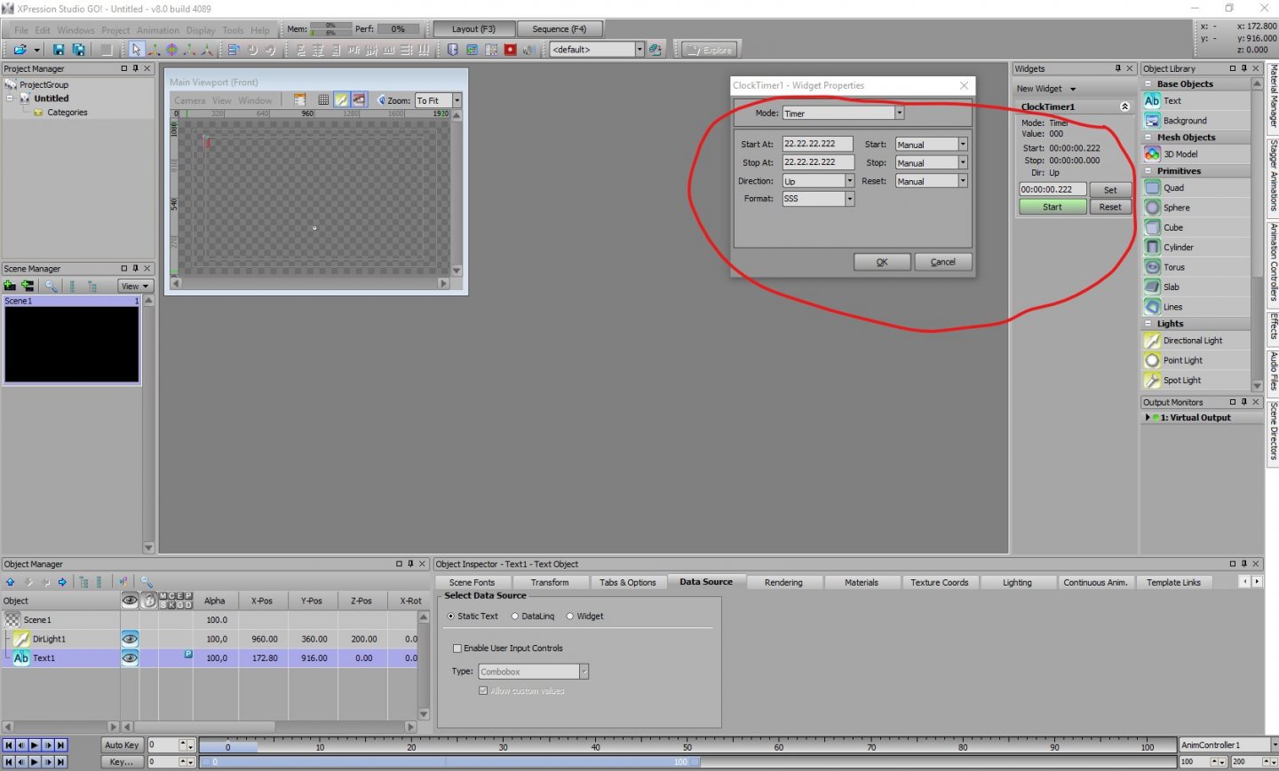

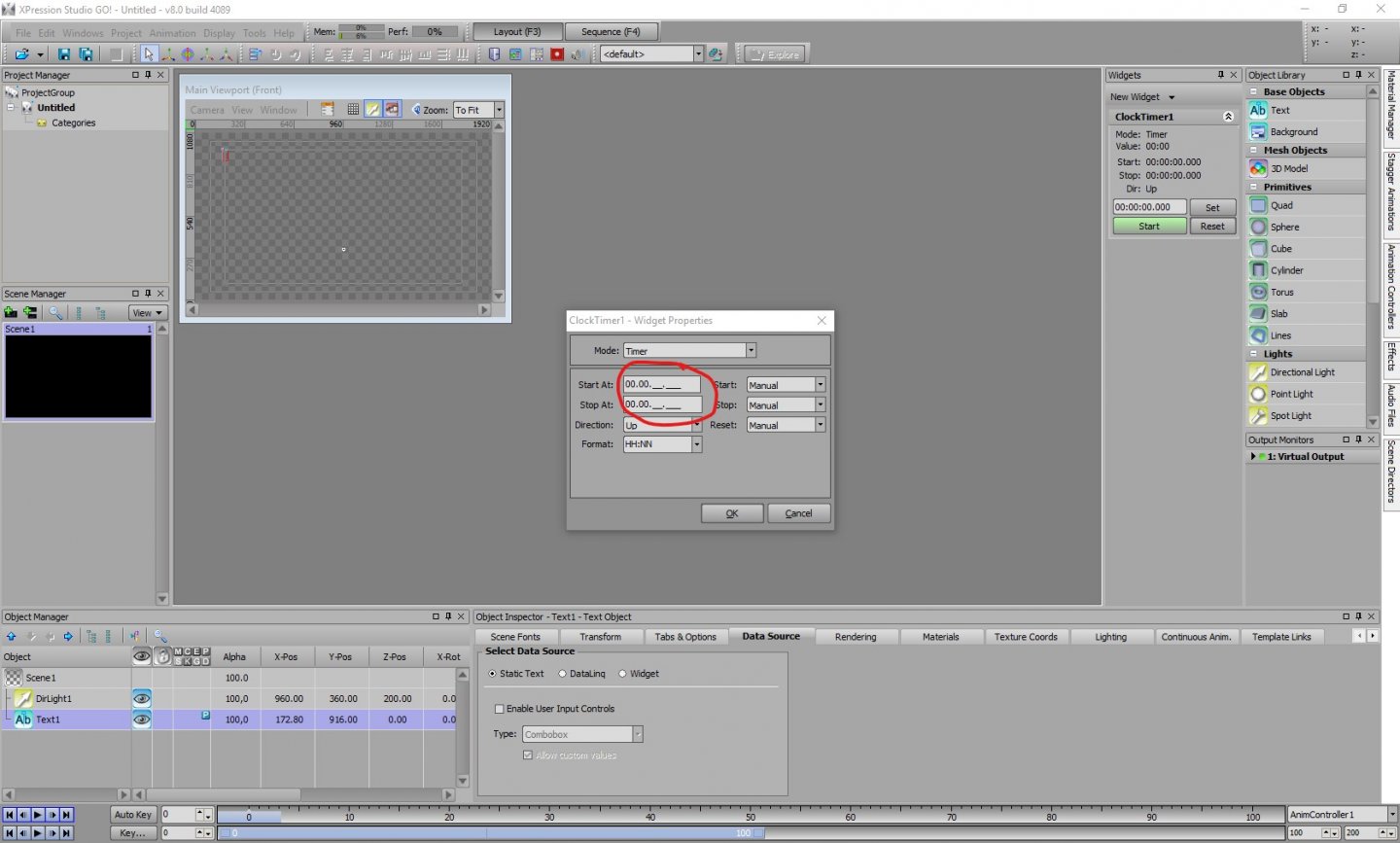

    Hi!
    I can't set the time in the timer widget. I can write numbers where the underscore is but when i press okey the numbers dissapear or go to the milliseconds instead of seconds or hours. Changing format or direction does not help. Did not have this problem while running Xpression 6.5 on Windows 7 and 8 but started having this problem running 6.5 and 8.0 on Windows 10. Tried uninstalling all versions off Xpression without any luck. Only Xpression 8.0 is now running on the system which is a laptop running Windows 10. Also tried on another laptop running Windows 10 and Xpression 8.0 with same problem.
  • 2.  RE: Can't set start at and stop at in Timer Widget
    Posted 01-22-2019 12:42
    Found the solution but maybe this should be fixed? I only had Norwegian BokmÁ¥l as keyboard language. Adding English (USA) did the trick.
