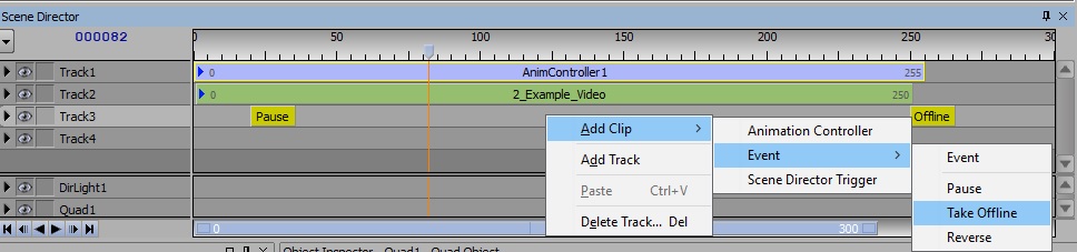

    Any animation that has a pause or other event in the timeline will not automatically take-offline at the end. You need to add a "Take-Offline" Event to the end of the timeline (see screenshot attached) . (Not sure if that's what you meant by "event marker" but that's something quite different. Sometimes, if the animation needs to be paused and reversed, then I add the "Take-Offline" event to the beginning and set it to only activate when it plays from the right. I hope that makes sense.
