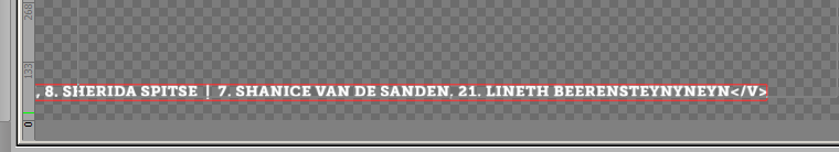

    I'm encountering a problem when I want to display a crawl driven by datalinq of 11 names from the players in a soccer-team ("00. Firstname Lastname"). The last characters of the last name is displayed not correctly... (XPression-Studio-6.5_3550)
    This is the text in Excel:
    This is within Datalinq (note the last name (#11) from Excel is not showing and instead there is are extra characters behind the #21 and a )
    And this is what XPression makes of it...
    When I decrease the number of characters in this crawl (instead of "firstname+lastname" only "lastname") the problem is gone.
    So I suspect the Datalinq field is limited to a specific number of characters. Can somebody tell me what the limit is?
