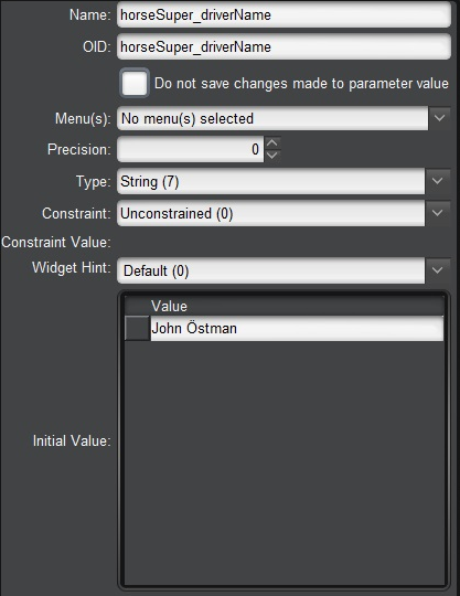

    In Dashboard we have for example this parameter, where the parameter got this Value:

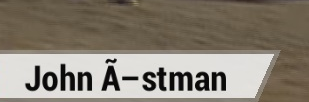

    But we have problems when streaming them to Xpression. In the Dashboard Datalinq in Xpression we find this:
    The font in Xpression supports the scandinavian 'æøåö' etc.
    What are we doing wrong? It worked in our previous install of Dashboard.

    Hi
    Put this in the Dashboard.ini file (under c:\Dashboard)
    -Dfile.encoding=UTF-8
    If you are running XPression version below 6.7, you will also need to get a new datalinq module off Ross.
    Simon
