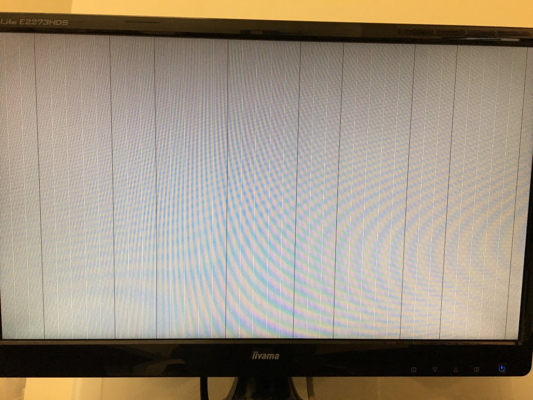

    Hi
    Has anyone tried getting at external key out of a Blackmagic UltraStudio HD Mini in XPression? I find it works fine until the 1080p50 - > 1080p60 rates, where I just get black and white vertical lines. Don't think this is an XPression issue, but if anyone else has the ability to confirm that would help.
    I have the latest Blackmagic driver, 10.9.7, and am using the latest beta version of XPression Studio. It is running on an HP Omen laptop under Thunderbolt 3.
    Simon

  • 3.  RE: Keying issues at 3G frame rates using a Blackmagic UltraStudio HD Mini
    Posted 12-19-2017 12:40
    Hi
    I tried it without the LCD panel and still get the same results. I've attached a picture of how the key output looks when the fill is black.
    I also had a bouncing box going around the screen, and you don't see any change in the key output which is odd. I have raised this with Blackmagic as well, so hopefully it can be fixed.
    Simon
