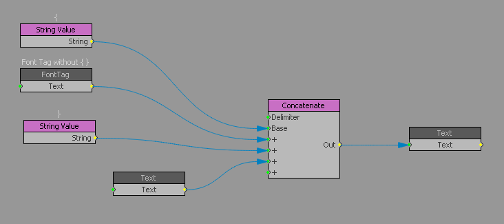

    TextWithTags is not available in Visual Logic in Xpression version 6.5
    Don't concatenate directly a text object that contains a font tag formula like "{myFont}" : tags will not be taken into account (it seems to be parsed by xpression and the information is lost ).
    A trick to make it work is to concatenate string value "{" with the text object "myfont" and with string value "}
    See project sample with global list radio button : [ATTACH]n16528[/ATTACH]
