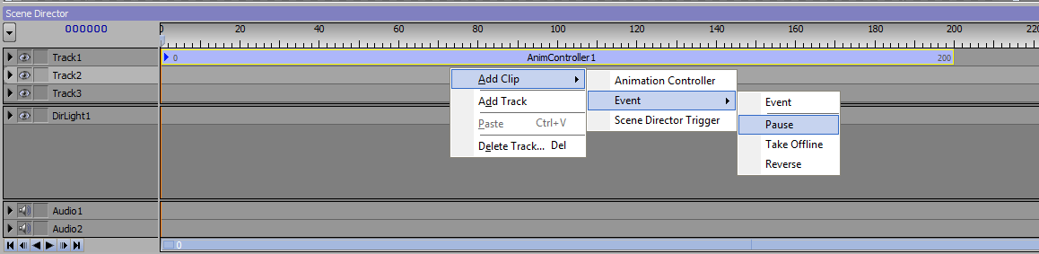

  • 3.  RE: Xpression Animation Stager: triggered Stops
    Posted 04-04-2019 23:03
    Thank you so much, James. Sorry to bother you a little, may i be able to have a screenshot of where can i find the pause event so i can add it to the scene director? I’m using the 6.0 Version.
    Kind Regards,
    Rudy.

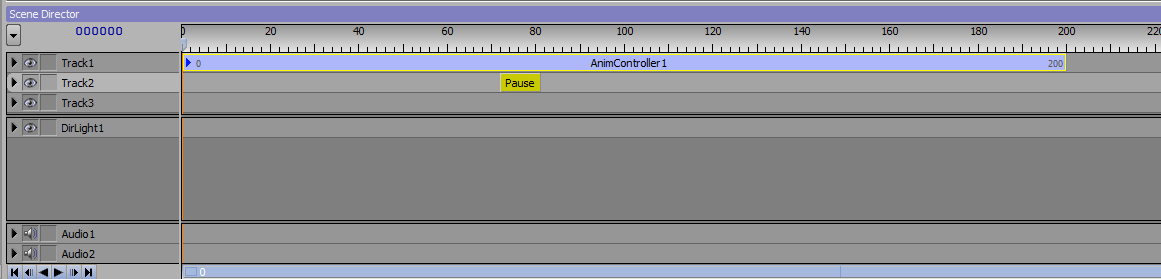

  • 4.  RE: Xpression Animation Stager: triggered Stops
    Posted 04-04-2019 23:07
    Here you go:
    This is how it looks when on the scene director:
