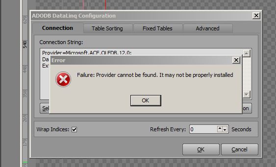

    Can someone help me with this error message regarding excel? I know I have microsoft office installed.
  • 8.  RE: Unable to edit excel path in datalinq when selecting template
    Posted 07-10-2018 17:38

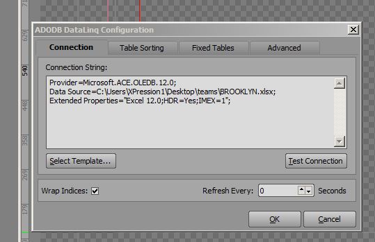

  • 9.  RE: Unable to edit excel path in datalinq when selecting template
    Posted 07-10-2018 18:04
    Thanks again Garner. That did the trick.
