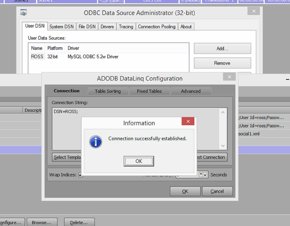

    So we won't be using the UDL file at all.
    Hopefully your new SQL server is on the same network as the XPression?
    What you want to do is get the Windows DSN on the XPression PC to connect to the MSSQL database directly. By using the Windows System DSN to connect we can eliminate XPression from the connection entirely, so no one can blame the XPression software ;)
    (And this is the best way to establish the connection)
    Can your IT add the MSSQL server to the System DSN on the XPression PC?
    Control Panel > Administrative Tools > Data Source (ODBC) > System DSN
    It's possible they will need to use a 32bit connector and the 32bit System DSN to connect. Depends on the DSN type and connector support.
    C:\Windows\SysWOW64\odbcad32.exe
    So before even working with the XPression software we need to get a successful Windows System DSN connection to the MSSQL server in Windows itself.
    After that connection is established all you have to do is go to Datalinq, select a ADODB data source and in the connection string put in 'DSN='name_of_DSN_in_Windows_System_DSN;'. See the attached image.
