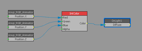

  • 1.  Keyframing the diffuse HSL on a directional light?
    Posted 08-11-2018 19:55
    I use a directional light bound to a specific material to create a 'dim down' effect by keyframing an alpha change on the light. I now need to control the HSL of that "dim down" effect and I can't figure out how to do this. Unfortunately, the material that needs to "dim down" to a specific color and opacity is always changing shapes - and there is not enough time to be creating duplicates.
    Any suggestions on a better way to do this?
    Thanks in advance

    With Visual Logic , you can bind "animatable" properties to the diffuse color of the light.
    For example the position of a hidden object where X,Y,Z are between 0 and 255 and represent R,G,B color :
    But color blocks only allow RGB values as input and not HSL as you needed. (maybe this could be a new feature to have a additional information in Color blocks to tell what kind of input is used : RGB or HSL )
