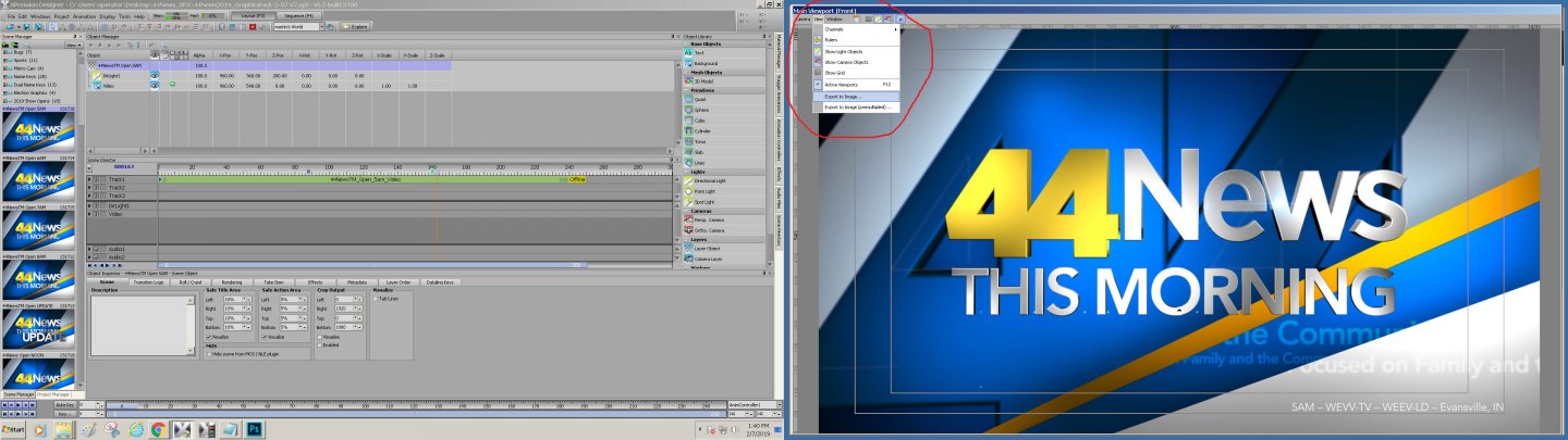

  • 3.  RE: EXPORT SCENE AS A JPG
    Posted 02-07-2019 19:44
    I export a capture of my scenes this way. Might be a more straight forward solution. All you gotta do is change the file type from .tga to .jpg before you save it down!
  • 4.  RE: EXPORT SCENE AS A JPG
    Posted 02-07-2019 21:13
    Ha, I totally forgot about that one! Nice!
