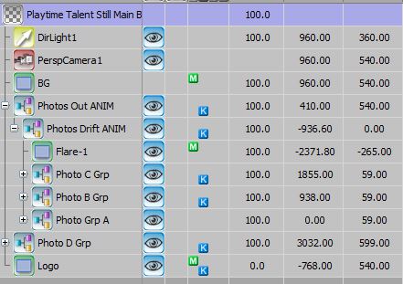

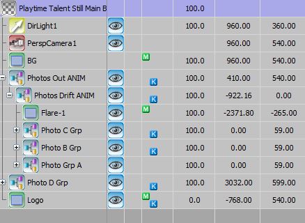

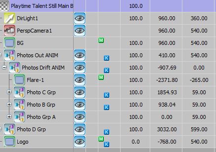

    Doing a very simple scene, and when I play it back, there is a 1-frame 'flash' wherein my animated quads vanish. This happens in both Layout and Sequencer. When I look at the X-Position Values for the objects in question, I can see that, in the problematic frame, they pop to 0 before returning to their keyframe values on the next frame.

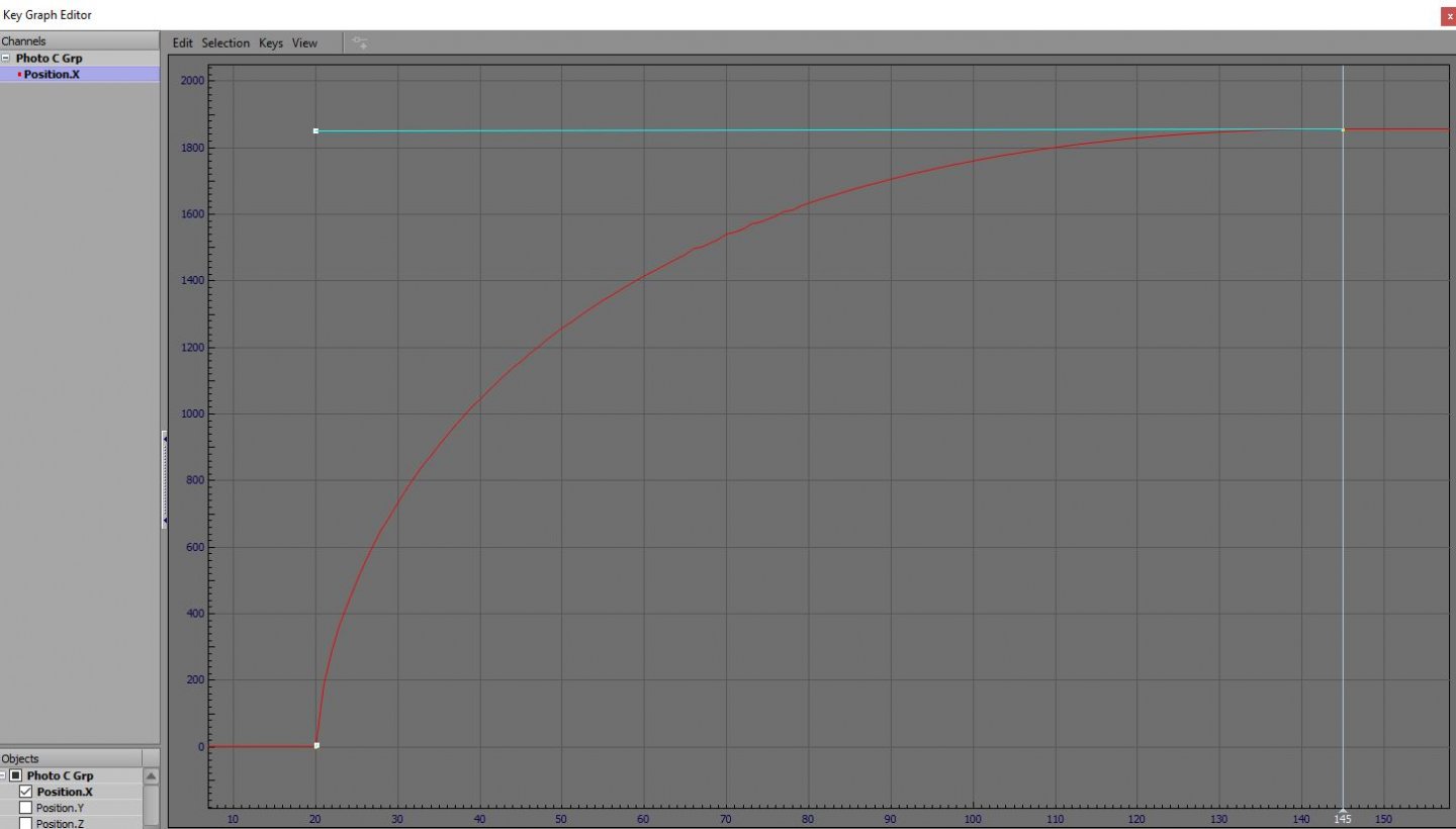

    I have attached 4 images...the first three show the values at frame 143 (good), frame 144 (bad) and frame 145 (good again). Specifically, we are looking at the X Values for Photo C Grp and Photo B Group. The 4th image is the animation curve. I have not had this issue before in this version and with these kinds of curves... I don't get what the problem is... any ideas?

    So, it seems the issue was in the curve, in which I brought the first handle all the way in to try and make a zero-value tangent, pulling it out juuust a little bit made the problem go away
