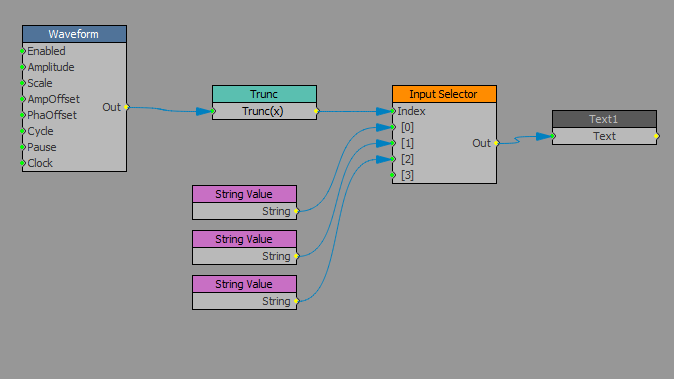

    Hello, I'm trying to create a lower third with subtitle information that would change between web address, twitter info, and email contact without having to multiple key animations on separate text quads. I was hopping I could use a "Timer" function via visual logic, but the code I have place so far isn't working? Has anyone created a working model for this? Thanks in advance.

    Hey ccomley,
    This might work for you.
    Change the string values to datalinq blocks instead though.

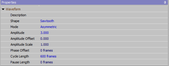

    The second image is my settings for the waveform generator. If you want to slow it down or speed it up just change the amount of frames.
