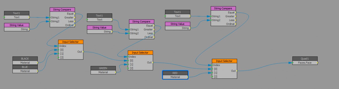

    Hey, you probably want something like the...
  • 3.  RE: Data field to Position L3 Left, Center, Or Right
    Posted 05-21-2018 11:39
    Obviously in the above example I am using it to control materials but hopefully it will put you in the right direction.
