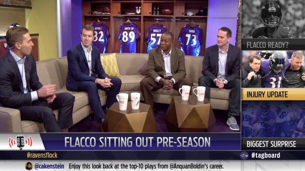

    Here is a screen grab of the scene, just so you can better visualize what's happening. When the topics to the Left on the side bar advance to the next topic, then all 3 move up, so that the topic in the 3rd box becomes the topic in the second box with the bar highlighted, the previously active topic slides up to the first position with it's image grayed out, and a new image slides up from the bottom to sit in that 3rd position.
    When this happens, I have the main text in the L3rd bar area (Currently reads "Flacco sitting out pre-season") scroll up with a new line of text relative to the new topic coming in to replace it.
    So far so good, continue points in a single scene director can nail that no problem. The curve-ball comes from them needing to change the text on that L3rd several times before advancing to the next topic. This is where I am hitting a wall, as I simply don't know enough about TL to even intelligently experiment.

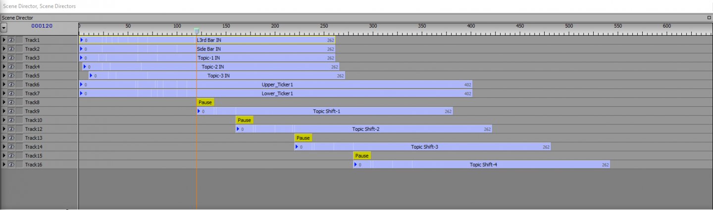

    Right - I do have right now separated animation controllers, I've attached a screen shot to show what my scene director currently looks like (It's just the 1 director at the moment).
    What I am getting from this is that I would need to create:
    - A scene director for the main in (where everything builds on and resolves to topic 1, with relevant text in the L3rd)
    - A second scene director that has ONLY the l3rd text advancing while the rest remains in place
    - A third scene director that has BOTH the topic and L3rd advancing.
    Of course these seem more like categories of directors, it feels like I would need to have multiple instances of each.. like an l3rd advance 1 to 2, and 2 to 3, and 3 to 4, etc up to the maximum amount of 'sub topics' which might occur between the main topic (on the side) advancing, and I would need to have these for every state the the side topic is in. As is, I have built it to have 6 side bar topics, with 5 of them being capable of moving into the center 'highlighted' position. This gives them some headroom above their stated goal of 4 topics per segment, with the idea that a fresh scene instance could be put in the sequencer for each segment of the show.
    So, to extrapolate that, I could have.. let's say 5 sub topics per topic, and 5 topics per segment which would mean I would ultimately have 26 scene directors in this one scene? And the big question then comes, how do I trigger one vs the other. The text compare condition in TL seems to rely on text either being there or not, or containing a specific value. Since all of the text will likely be pre-loaded, I am not making the connection on how to put this together.
    //Should be pretty basic
    //Build the L3 with Transition logic so only the L3 changes
    //Add an event in the L3 to trigger the LBar Scene Director to advance topics
