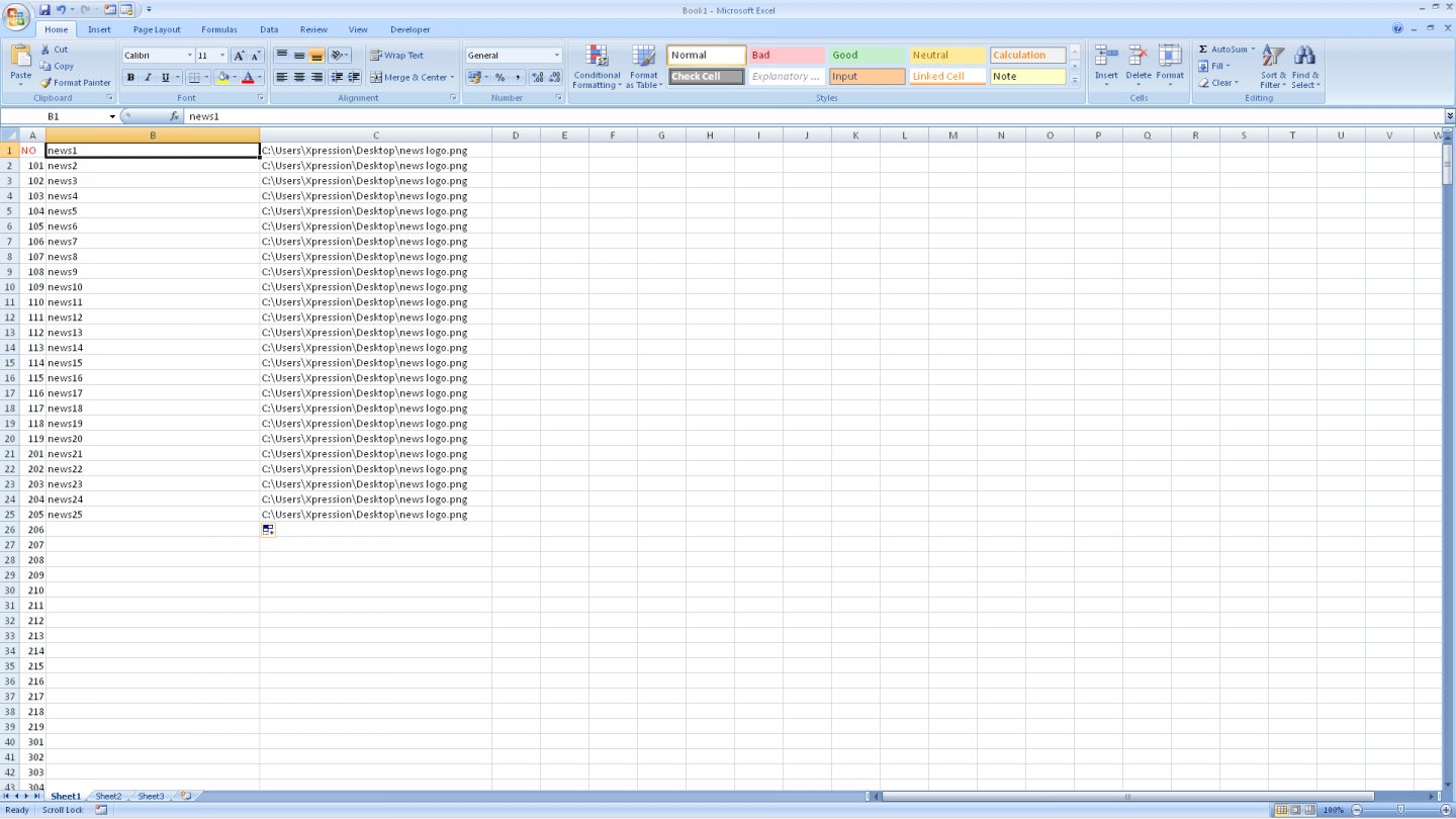

    now the problem is I linked with datalinkq a excel file.I created scene for text and logo.
    but line count is not static,every times it will change.Some time they write 20 some time more or less.if it happens I have blank lines.and this blank line and logo still appear on air.How to remove or hide this blank line and logo depend to filled lines.
    I Mean I have alrady 50 scene for text and 50 for logo,both linked to excel file,but if I have 25 line in my excel and I want my crawl skip blank lines and go back to start.I couldn't find any solutions.
    I also tried table in excel but stil not working.I see stil empty lines with logo .
    Help me pls.

  • 19.  RE: Datalinq Controlled Crawl
    Posted 01-05-2018 20:36
    When you say ticker, are you referring to a "crawl"? If so, you just use
    <n>
    <n+1>
    etc in the row field for each sub scene of the crawl. You would need to make sure that the Table Name that you export from Excel only highlights the number of rows of tweets that actually exist.
    i.e. if you export a named range of 50 rows in excel, but only fill in the first 5 of them, then datalinq will still loop all the way up to row 50 even though those rows are blank.. If you export the Excel as a CSV then you would not have that issue, as the datalinq knows how many rows exist in the CSV file and will automatically loop back to the beginning once you go past the end of the file.
    If you have issues; please post a sample project and I can look at it.
