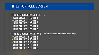

    I want to make a bullet full screen graphic with sub bullets. My question is, how can I set up the scene so the following text after the sub bullets adjust on the Y axis according to how many sub bullets there are within a bullet group? (example attached) For instance, if my bullet 1 group has 2 sub bullet points, I want the bullet 2 group to adjust in spacing to follow the last sub bullet point, and the same if I have 3 sub bullet points.

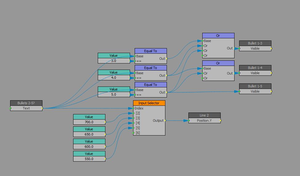

    There are a couple of ways to do this, but they all relate to the visibility of the bullet points driving the Y position of the line(s).
    What I would personally do is set up an operator control so they could set the number of bullets for a given group.. say 1-5. So, I would make a published text object in a layer set to only render on preview (so only they can see it). The text output of this number would then drive visibility for the bullet lines, and could also feed an input selector (set to 2 as default since you'd never likely have 1 bullet point). Connect the output of the selector to the Y position of the next text group and place values blocks in the 2, 3, 4, and 5 inputs of the selector corresponding to the desired spacing.

    Here's a quick example of how such a rig would look in Visual Logic:

    Bullet 1-3, 1-4 and 1-5 are the actual text objects comprising the bullet group. I made this with the presumption that there would never be less than 2 bullet points, and never more than 5, but this idea can be expanded out to as many / few as you like.
    The naming convention is irrelevant, it's just what I would have called them.. the 1 indicates they belong to line 1, bullet points for line 2 would be prefaced with a 2 (2-1, 2-2, 2-3, 2-4, 2-5) and so forth, but really just do whatever works for you naming wise.
    Bullets 2-5 text is just a text object the operator can enter a value into in order to drive the number of bullets visible in the scene. This also drives the Y position of the Line-2 text.

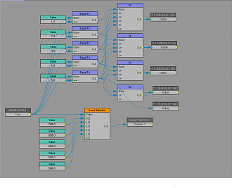

    I'm almost there. The only thing I can't figure out is the Y position of my 2nd line. Let me break it down more for you. I have a "Bullet 1 Group" that begins with a bullet line of text, and sub bullets 1-5.
    Then I have a "Bullet 2 Group" that also has a bullet line of text, and sub bullets 1-5. In visual logic, when I map the text indicating how many lines of sub bullets to the input selector with the 5 values to my Bullet 2 Group, it squishes the bullet 2 group up on the same Y axis as Bullet Group 1. I tried changing the values, but it doesn't move the Bullet 2 group on the Y axis.
    Do you know what I'm doing wrong? Should I have the bullets & sub bullets in groups? Thank you so much for your help.
  • 11.  RE: Bullet points, Sub Bullet points & Y axis positioning of following text
    Posted 10-11-2018 19:20
    I think I got it! I put the Input Selector to an offset of 1 and it seems to be working. Thank you for all of your help!

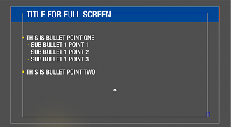

    One more question... If I want the bullet group 1 to have the option of zero sub bullets, how would I alter the Visual Logic?
  • 14.  RE: Bullet points, Sub Bullet points & Y axis positioning of following text
    Posted 10-16-2018 19:18
    (in order to space the 2nd bullet group correctly on the Y axis)
