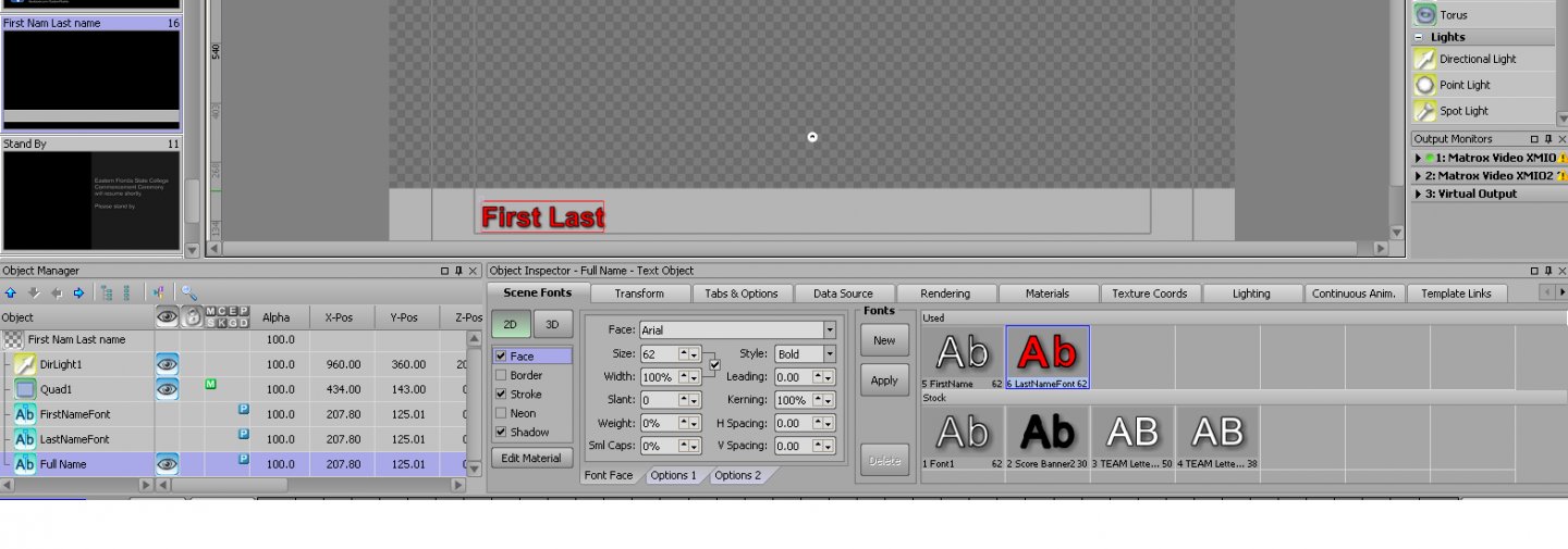

    Hopefully this is an easy one. Draft kings wants me to make the players first and last name a different font (see image IMG_0565).

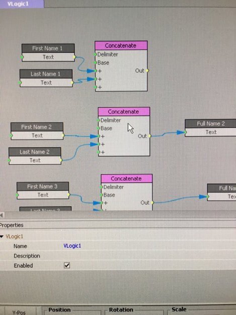

    Is there visual logic I can use to get this complete? IMG_0566 is the visual logic I'm using now.
    Thank you
  • 2.  RE: First and last name different fonts
    Posted 04-27-2017 15:04
    Yes, just add a "string value" block into your concatenate between first and last name. Set the string value to {LastNameFont} and then create a font called "LastNameFont".
  • 3.  RE: First and last name different fonts
    Posted 04-27-2017 20:04
    Worked perfectly. Thank you!

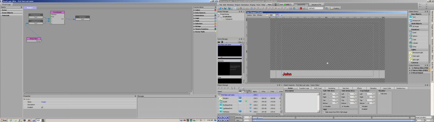

    Can you send more screen grabs? I'm having a problem
  • 5.  RE: First and last name different fonts
    Posted 05-08-2017 13:14
    This is what I have and not getting the correct output. Thanks

    Make sure you have the blue button at the top of your viewport turned on to see Visual Logic working in Layout (doesn't look like it's on in your screenshot)! It's the button called 'Show or Hide Continuous Animations in the Viewport F12'.
  • 8.  RE: First and last name different fonts
    Posted 05-08-2017 15:25
    Garner, Yes I do have it on. Not getting the results. Do I have the string Value in the correct place?
  • 9.  RE: First and last name different fonts
    Posted 05-08-2017 15:50
    No, the string value should be fed directly into the concatenate, between the first and last name blocks.

    Here see this screenshot:

    Make sure the text object is not already set to use the red font.. I would try selecting all the text in it and double click the white font to ensure that the first part of that text object is set to white..
  • 14.  RE: First and last name different fonts
    Posted 05-08-2017 17:12
    Will I did get it working by un-linking the LastNameFont to the Concatenate, then reconnecting. It must not cleared from the last time.
