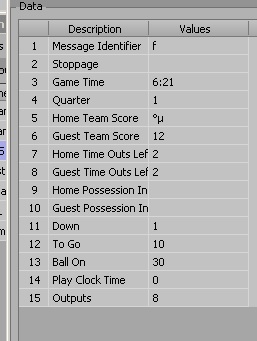

    One issue that is coming up is, whenever we go into triple digits for score, it shows a really strange character. When we compare our datalinq configurations to the old one, they seem exactly the same, but the old system was able to show those triple digits

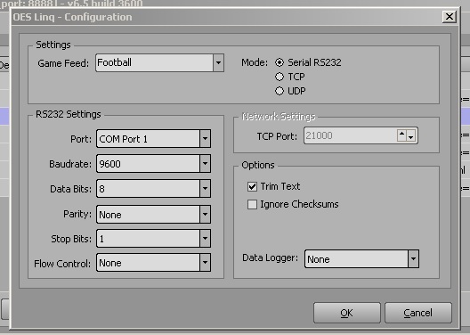

    The OES football protocol only supports two digit scores. Perhaps you could contact me off the forum and we can set up an email between you, us, and OES.. It's not clear to me how any other system receiving the same OES data could have done anything different than XPression. The data we receive from OES does not contain either the data for which side of the field the ball is on, nor a third digit for score. If you could capture some of the data when you have three digit scores we could analyze it to see what it is showing and how it compares to the OES specification. There is an option in the datalinq server to log the data to a file (as either ASCII or Hex or both). The log file is located in the datalinq servers progam file folder. Could you capture that and send it to us? Which site is this; perhaps it is not using the standard OES protocol and it had some custom OES implementation?

    OES appears to have made some modifications to their protocol to allow three digit scores. We will implement this and make a patch available.
