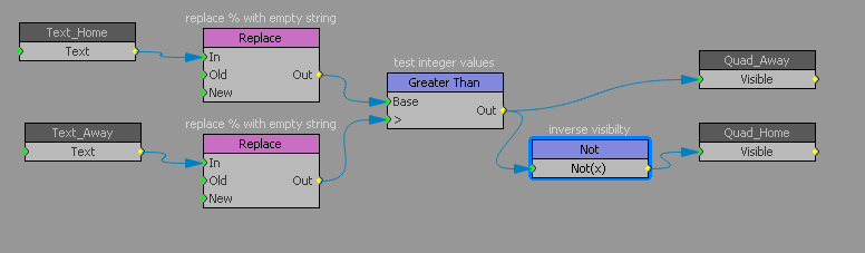

    With Visual Logic you can try this :
    Replace blocks are used to remove % characters so they can be interpreted as numbers .
    The result of "greater than" block will drive visibility of the two objects.
    Hope it helps.
