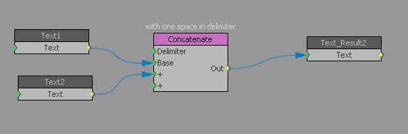

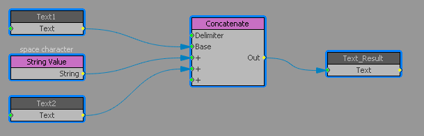

    In your string value block put spaces into the value, and not the string "10" .
    Concatenate block takes all strings input and write them one after another to generate a single string.
    You can also put the spaces in the Delimiter parameter of the "Concatenate" block and avoid the string value block : the text in "delimiter" will be added between all string inputs
    See project attached : [ATTACH]n16678[/ATTACH]
    Scene1 : with 2 texts
    Scene2 : with more than 2 texts to better understand how concatenate and delimiter works.
    Hope it helps.

    Thanks A, that did help. I didn't know about the delimiter function at all, actually having only used the Concatenate block for the first time when I deployed your font resizing logic. Turns out it what I had was working, but your example helped clear up some of the 'why' questions I had.
    Cheers!
