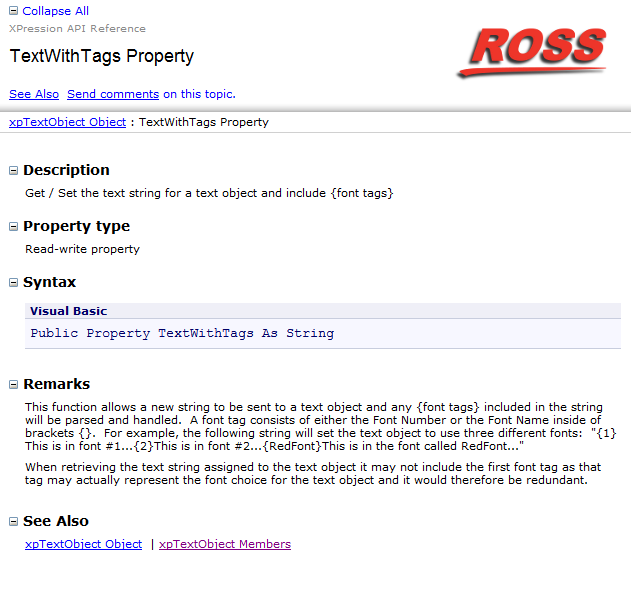

  • 2.  RE: When and where can I set a text field material macro?
    Posted 06-20-2018 01:20
    obj.TextWithTags = "...."
  • 3.  RE: When and where can I set a text field material macro?
    Posted 06-20-2018 04:05
    Thanks, Brian!
