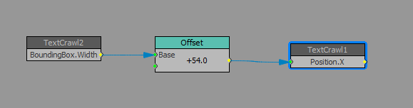

    Set text to centre and then use VL. Take boundingbox of text, use an offset block for position and then connect it to the X Pos of the twitter logo. I've attached a pic of something similar.
  • 4.  RE: Quad that follows Auto scaled text?
    Posted 08-24-2016 17:51
    Here you go:
