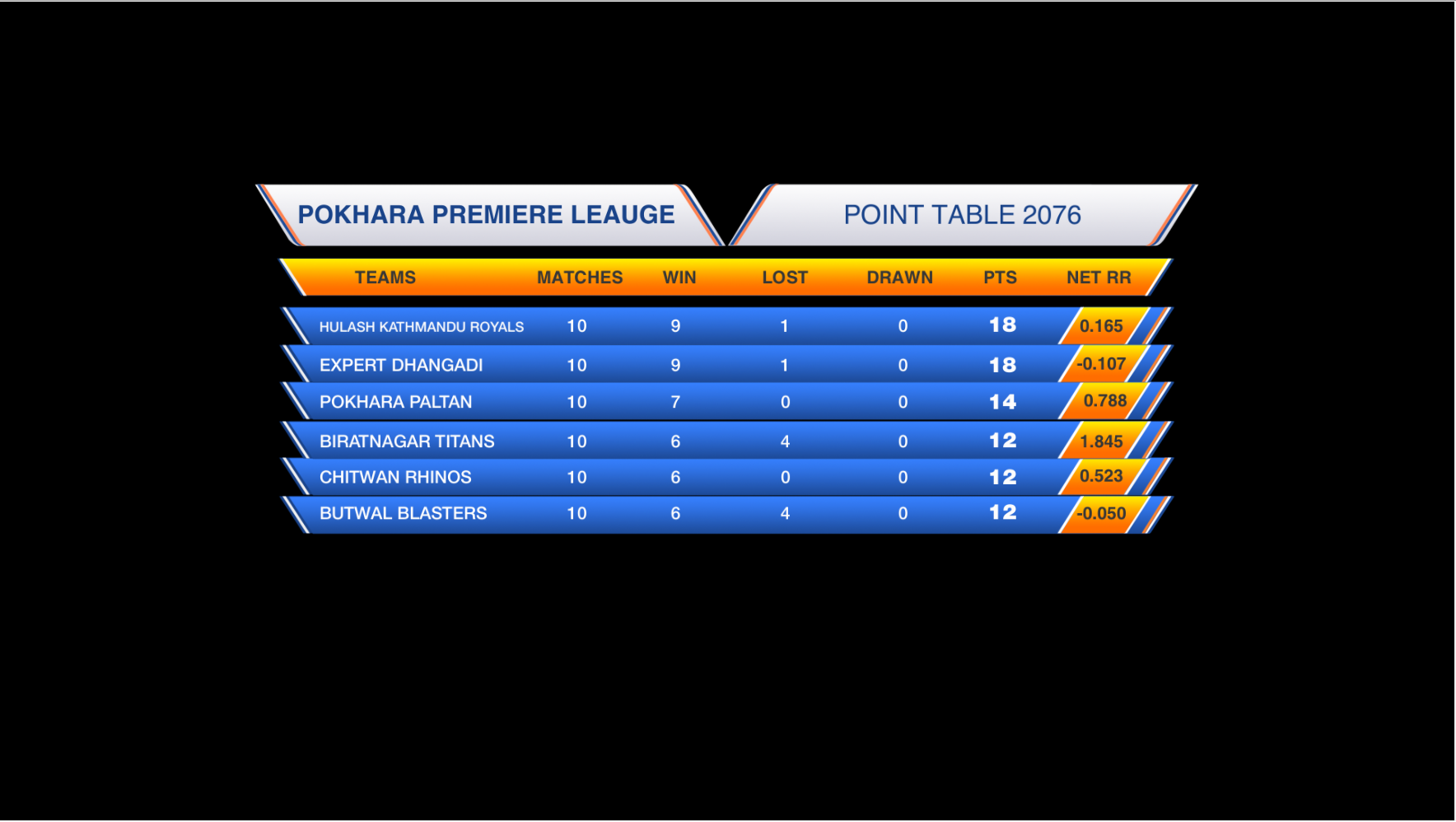

    hello Experts as you can see in image , i want to compare pts field and arrange all group in descending order. but if pts field is equal then i want to compare net rr field to set descending order. i use visual logic to compare pts and make it descending order but after that if pts field is equal then i cannot set comparing Net rr.

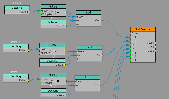

    Hello Sunil,
    if "Net rr" values are between -X/2 and X/2 , you can use  ("Pts Fields" * X + "Net rr" ) as computed values to sort.
    Here is an example with X=10 , visual logic looks like this :
    this should work,
    regards,
    Antoine

    Posted 11-04-2019 19:58
    Thank youmignon . Yeap it will work . I had tried only adding ptsand net rr field so i got some mistake but multiplyibg by 10 it will help. Thank you again
