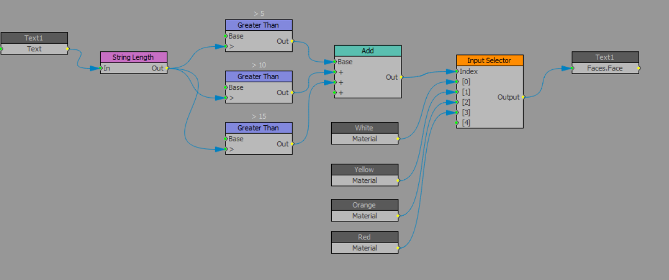

    Brand new to Xpression and was basically told, "figure this thing out, will ya?" We had a week of training, but now questions abound, especially with Visual Logic. I'm already struggling with basic logic constructions that I could breeze through in After Effects expressions (that extra "e" makes a big difference).
    Just as a mental exercise, I tried to make a text string that would start white, change to yellow after 5 characters, orange after 10, red after 15, and stop accepting input at 20. White to yellow was easy enough. Then I thought I could use And blocks and an Input Selector to do the rest, but nothing doing. I can't even access any values of the Input Selector beyond 1 and 0. If And block returns 1, it's Material 1, and Material 0 if it returns 0. No idea how to access any values other than that.
    Do input selectors not work that way in combination with And/Or blocks? How do you access values above 1 in an Input Selector? And is there a help document that explains all the function blocks or goes more in-depth on VL than the Xpression User Guide? I've been unable to locate anything on the site.

    Posted 02-07-2019 20:41
    Maybe this picture will help give you some ideas..
  • 3.  RE: Input selectors
    Posted 02-07-2019 22:12
    Thank you! That makes a bit more sense. I'm able to backtrack it and see what you did (not sure I'd have come across that on my own). Is there an online document that lists all the function blocks and their operation? I see it's in the online help but I'm not always at the Ross workstation.
