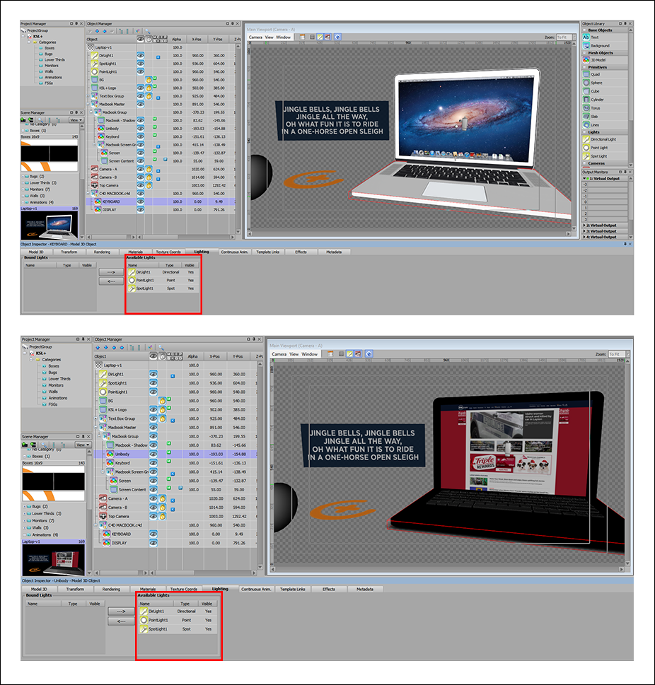

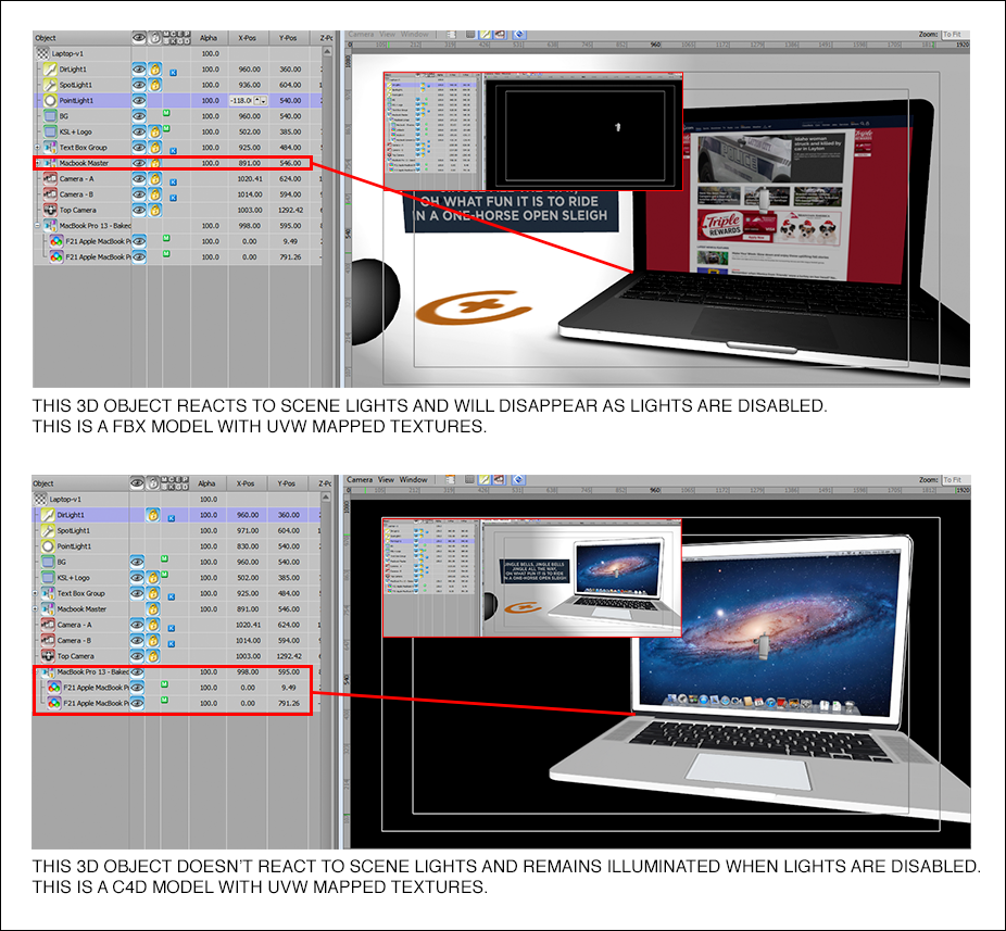

    Hi forum,
    I'm trying to figure out why these two different 3d models are responding to the scene lights differently.
    Any help would be much appreciated!

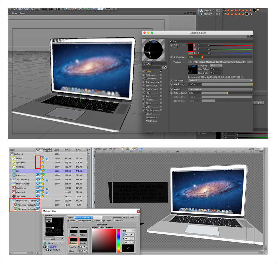

    Check the materials that get brought in - the emission color might be set to white, which would ignore lights

    I checked the model and textures in C4D and set the emissive color to black in XPRESSION. Any other thoughts?
  • 4.  RE: 3D object doesn't react to scene lights
    Posted 11-25-2019 14:40
    Have you checked your light bindings to see what may be different?
  • 5.  RE: 3D object doesn't react to scene lights
    Posted 11-25-2019 22:22
    It looks like the lights were applied to each version of the laptop model. I unbound the lights and got the following result. Thank you both DD & Shane for your help!
