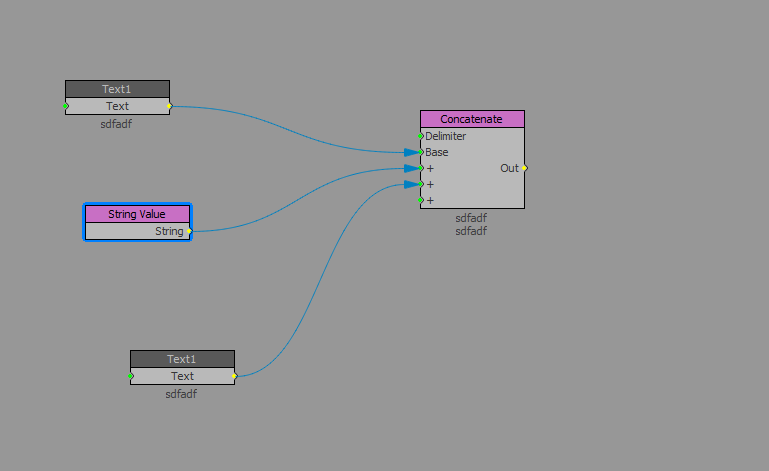

    Hi, is there a block in visual logic or something to simulate an "enter" in a txt?
    I know how to change a font, exemple : {9}, but how to do an enter, I forgot!

    Hey Pierre,
    I'm looking into why text with tags doesn't work in VL. In theory oyu should be able to use a concatenate and place the text with tag you require.
    Here is an alternate method via VL that uses !! as the break tag.
    https://transfer.rossvideo.com/f/c59934a16204c5f1
    Enjoy!
    Peter

    Pierre,
    use \n instead

    I've try but did'nt work… only \n ?

    Sorry Pierre you need to turn "parse escape characters" on
    Here's a quick project:
    https://transfer.rossvideo.com/f/02abe8590eb45fc8
    I hope this clarifies things! : )

    Thx it work, I should saw it :) (parse escape characters)
