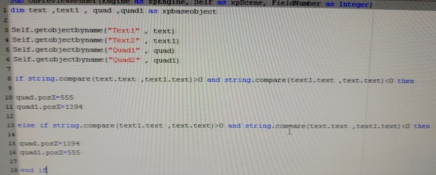

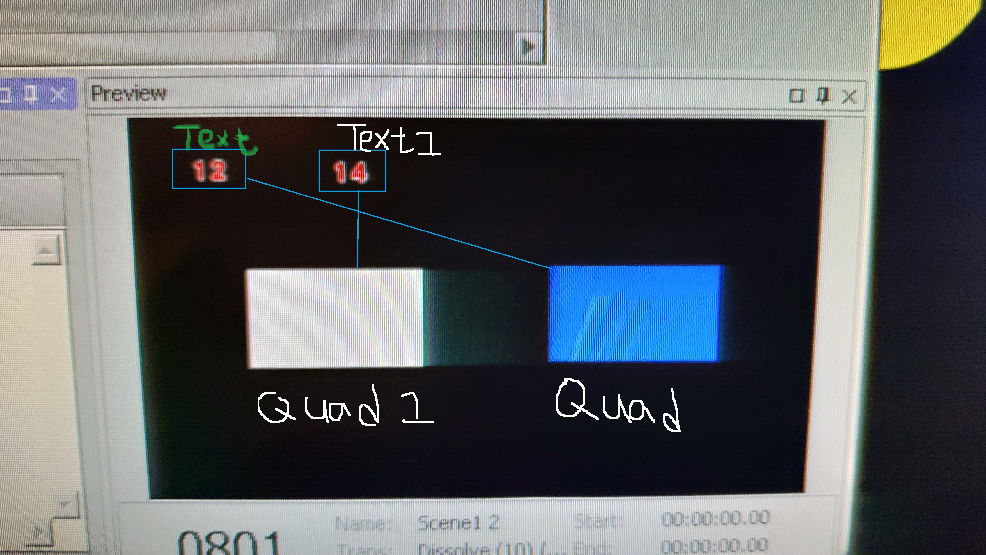

    as title,   text1 > text   ,the Quad1 need to move left , when  i compare 12 and 14 the script is working

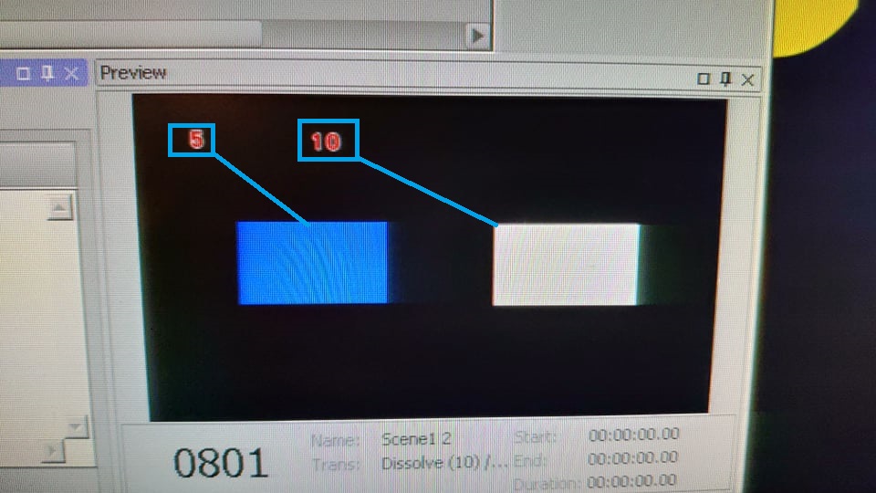

    But when i compare 10and 5 , the script is not working,what wrong with my Script  THX

    string.compare is doing an alphabetic sort.
    10 is less than 5 when sorted alphabetically (not numerically).
    It seems like you actually want to compare the values as numbers, not just as a string.

    Something like:
    CInt(text1.text) < CInt(text.text)
