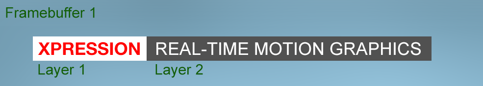

    I want to create a lower third graphics using 2 or more elements (Title + Sub + Details) running on the same framebuffer, different layer (in order to control it one by one) and concatenated as a "child", using transition logic for smooth transition, variable text length.
    Something like this:
    Is it possible?

    Hi Gabriel,
    I think I get what you are trying to achieve, but as far as I know, it's not possible natively in XPression the way you would like to use it :-)
    Allow me to clarify.
    If I understood you correctly, you have one Take Item in the sequencer with the content ROSS / REAL-TIME MOTION GRAPHICS on air and you have a second one that says XPRESSION / REAL-TIME MOTION GRAPHICS. When you put the second one on air, I assume you would like the ROSS to fade out while the white strap grows until it can fit XPRESSION in it which then fades in or something. Am I correct?
    The issue that we have here is that the second take item does not know what's on the first take item. So it can't adjust to the size of a text that it doesn't know about.
    For the same reason it doesn't make a lot of sense to put ROSS and REAL-TIME MOTION GRAPHICS in two different scenes on two different layers. The correct thing to do here would be to put it in the same scene and use Visual Logic to adjust the position of REAL-TIME MOTION GRAPHICS according to the size of ROSS.
    Now, if you really want this to work from within the sequencer, you can make it work but then you have to add the information twice and you would need to use an old content textobject and a new content textobject in the same scene and make an animation using visual logic where you adjust from the size of the old content to the size of the new content.

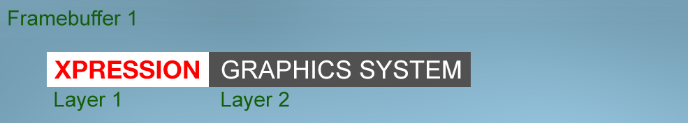

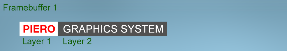

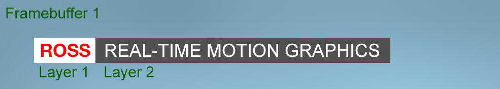

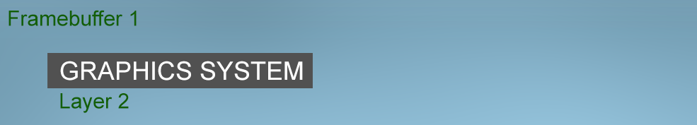

    Hi Kenneth, thank you for reply!
    I want to have different Take Items for Layer 1 and 2 in order to play them as is needed - one by one or both - logicaly displayed.
    Take Item 1; Scene 1 = ROSS
    Take Item 2; Scene 2 = REAL TIME MOTION GRAPHICS
    Take Item 3; Scene 1 = EXPRESSION
    Take Item 4; Scene 2 = GRAPHICS SYSTEM
    Take Item 5; Scene 1 = PIERO
