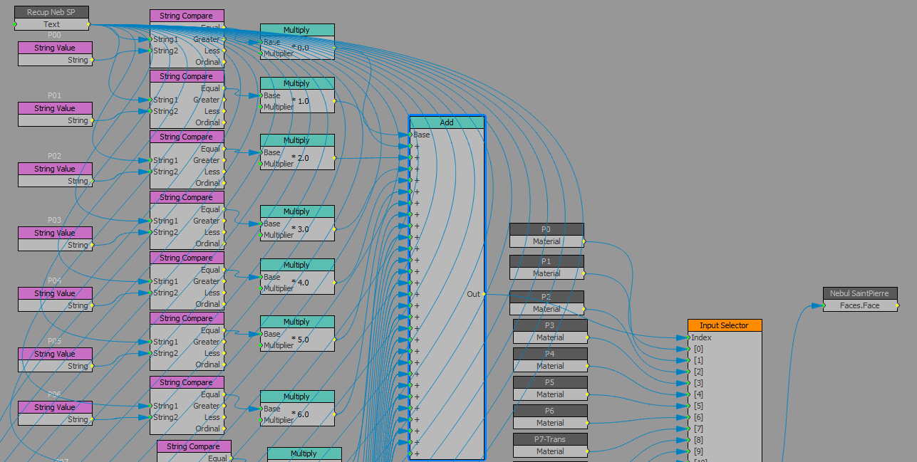

    I'd like to use a script to assign a face material to a quad depending on the code ( P01 to P27) obtained from a datalinqed xml file (http://adress.xml  for example)
    I did that with VL but I'd like to start using scripts and I don't know anything about  scripting!
    If somebody would be kind enough to help me I would really appreciate it.
    The explanations for the lines of code would be a plus for me to understand what does what!
    Here is a sample of how I did it in VL , if  it can help you to understand what I need
    Best regards
    Michel

    does that input selector go all the way to 27!??? Goodness!
    To me it looks like you have a text object and if it says P# apply the P# material to your quad. Do I have that right? If so you may be able to have a very simple code that takes the contents of a text object and passes that into a SetMaterial method directly to your quad.
    There could be some more questions here that need to be answered, but I think you can probably get something very straightforward with under 10 lines of code.

    Brandon may have something more specific, but here is a simple OnOnline script:
    ' Declares Objects within your scene as specific datatypes
    dim quad as xpBaseObject
    dim textChecker as xpTextObject
    dim quadMat as xpMaterial
    'References the Scene to find objects in your Object Manager
    'the two objects would be called TextChecker and Quad
    Self.GetObjectByName("TextChecker",textChecker)
    Self.GetObjectByName("Quad",quad)
    'Uses the GetMaterialByName method to pull in
    'a material from your material manager and assigned it as the quadMat variable
    'the textChecker.Text references the Text Property, or contents of your text box
    'in your case it could be a datalinq source
    'A material called "P0" would be assigned
    'if the string "P0" was in the text field
    Self.Project.GetMaterialByName(textChecker.Text,quadMat)
    'With the proper objects assigned, we still need to take 1 more step
    'Here we are telling the quad object to use the SetMaterial method
    'the 0 represents the index of the face we are assigning
    'from above, quadMat = textChecker.Text
    quad.SetMaterial(0,quadMat)

    Thanks so much Martin, your script works perfectly.
