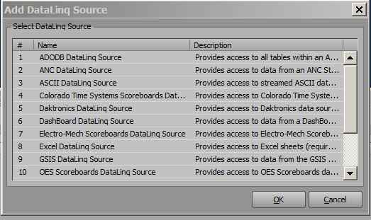

    These are the only options I see. I tried using ADODB DataLinq Source like the video in Xpression U showed.
    Couldn't find the one you mentioned in the list. Any idea what I might be doing wrong?

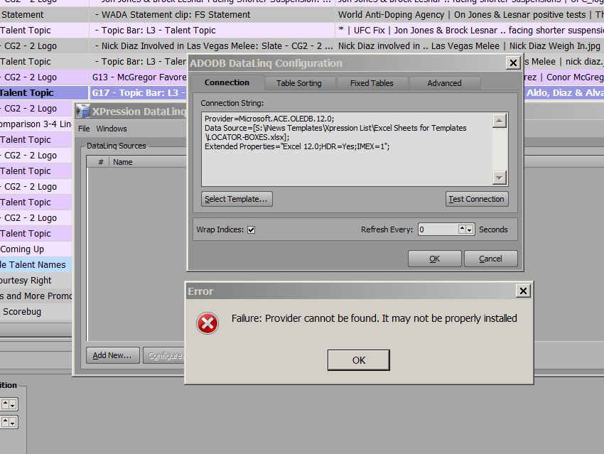

    Posted 08-25-2016 23:23
    Here is the error. I feel like I've tried everything but can't get it to work.

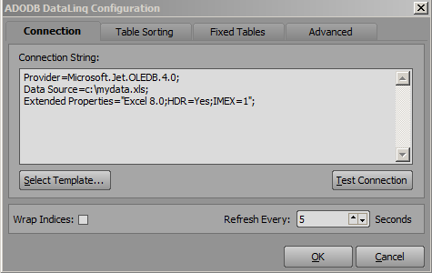

    When you click "Select Template", choose this option "Excel Mixed Numeric/Text Data" instead of the XLSX option.
  • 8.  RE: Datalinq Setup
    Posted 08-26-2016 02:11
    It should look like this.. You should remove the square brackets around the filename.
