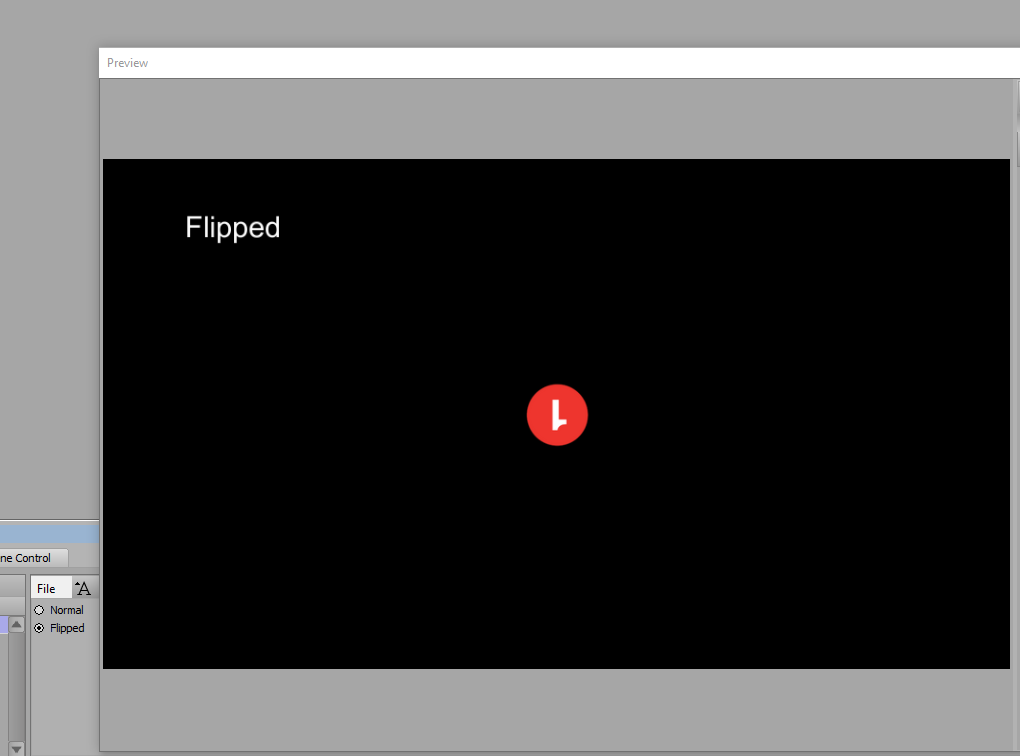

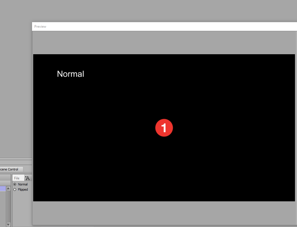

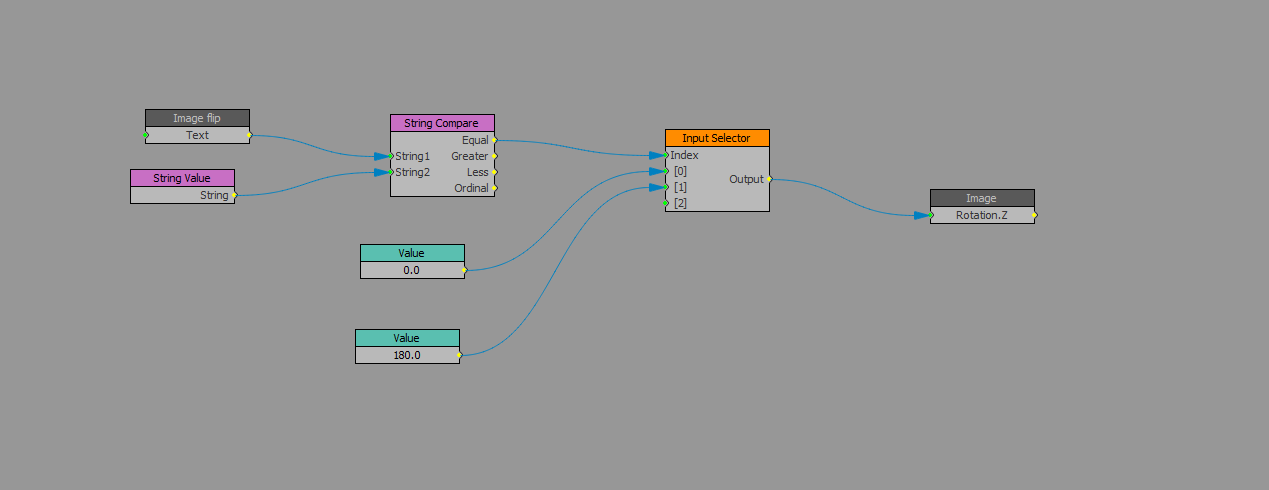

    What you need to do is think of it as a rotation rather than a "flip".
    If you rotate on X or Y you will get the back face of the quad which will just be black. Instead rotate on the Ze (or Zed) access.
    I have a project below for you! :)
    Here are some screenshots of the VL:

    Note, that a rotation of 180 on the Z axis will make the image go upside down.  This is not the same as a rotation of 180 on the Y axis, as that will make the image flipped left to right.  If that is what you actually want (it's what your original post asks for), you can rotate 180 on the Y axis, but you need to enable the "double sided" checkbox on the material that you have on the quad, otherwise the reverse side of the material will be unlit/black.
