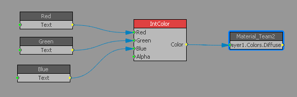

    The RGB text objects would then populate an INT Color block in Visual logic and then the value of the Int Color Block would populate the material. In theory I think this would work, however my scripting is a little shaky, any help is appreciated!

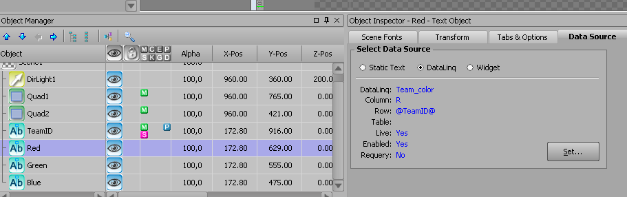

    to populate a text object from another, you can use Datalinq and @TextObject@ macro feature.
    In your case , define a new datalinq that contains R,G,B values for each of team ID . Make the rows match the team IDs.
    for example :
    ID_TEAM;R;G;B;TEAM_NAME
    1;0;0;0;not-used
    2;0;0;0;not-used
    3;0;0;0;not-used
    4;0;0;0;not-used
    5;0;0;0;not-used
    6;0;0;0;not-used
    7;0;0;0;not-used
    8;255;0;0;red team
    9;0;255;0;green team
    10;0;0;255;blue team
    11;255;255;255;white team
    23;128;128;128;grey team
    bind your "Red" "Green" and "Blue" text objects to this new datalinq , set the row info to @TeamID@ (assuming "TeamID" is text object containing the team id from 8 to 23
    keep your first idea with visual logic to set the color :

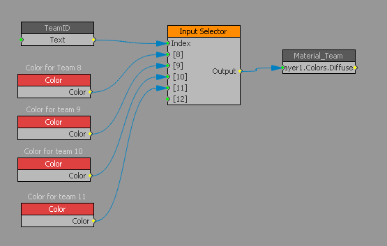

    There is another solution with pure Visual Logic where colors are "hard coded" in VL and use Input Selector :
    (sample image only show for team 8 to 11 , you'll have to make it up to team 23)
    Hope it helps,
