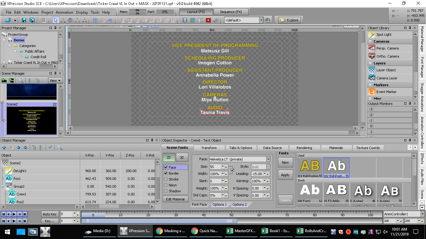

    Mainly, you need to position mask above other elements in Z-Pos and "Render Order Priority" the text (Crawl/Roll) as Normal.
    Link: https://www.dropbox.com/s/c4a9zivqfdbuhsz/Ticker%20Crawl%20VL%20In%20Out%20%2B%20MASK%20-%2020191121.xpf?dl=0
    Have FUN!

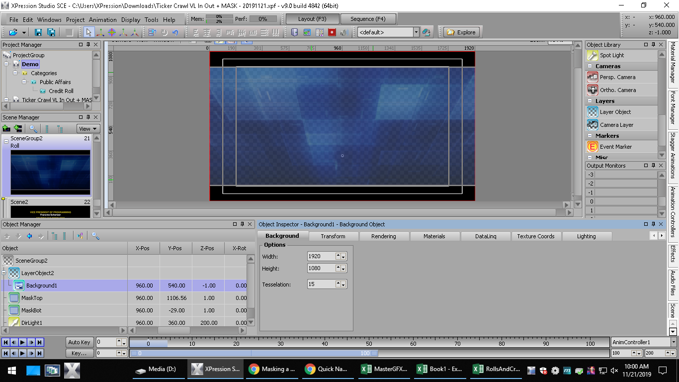

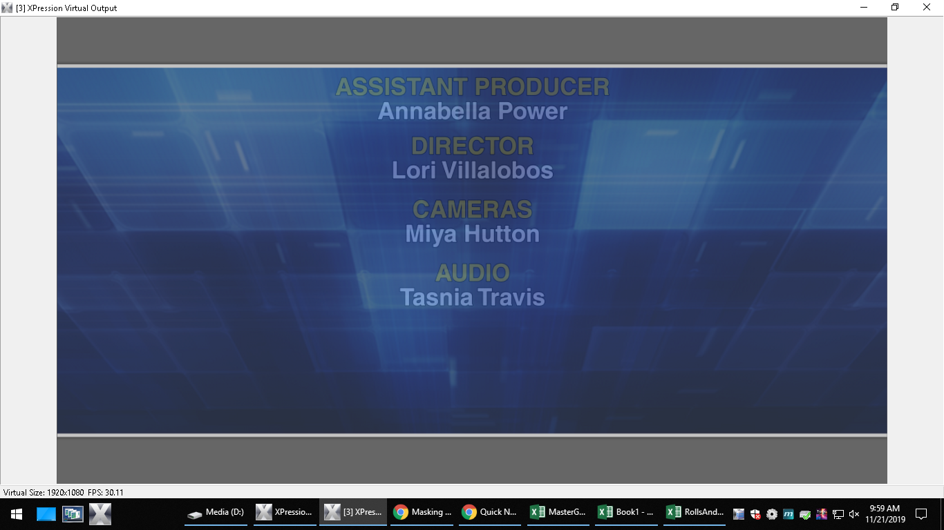

    Update: Nope. My text is now semi-transparent, like my background is.
    I tried setting the background z to -1, so it should behind the text, but that didn't fix it.
    I have no idea why that is happening.
  • 7.  RE: Masking a Roll - Solved
    Posted 11-21-2019 14:51
    Please post a screenshot.
  • 8.  RE: Masking a Roll - Solved
    Posted 11-21-2019 15:02
    Thank you yet again. I hope this gives you the information that you need.
  • 9.  RE: Masking a Roll - Solved
    Posted 11-21-2019 15:50

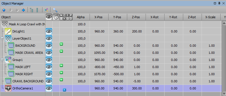

    Please download again the updated project in the link above.
    You have to "compose" the background:
    1. In the Layout Object put the Background and mask crawl/roll area
    2. Put again same background in the same location in the root and use it at the background on crawl/roll area.
    Have FUN!
