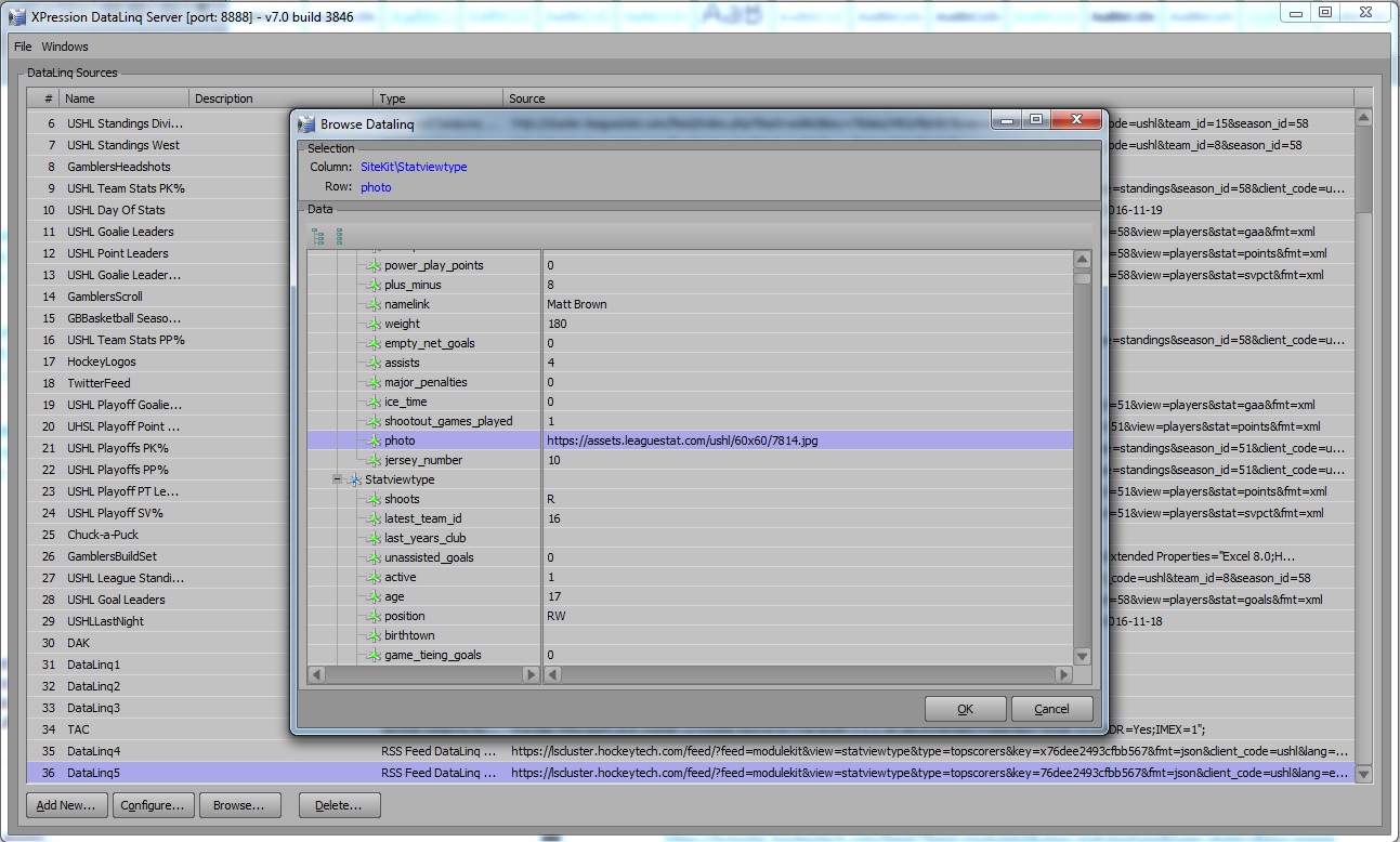

    I would like to add photo's to a few graphics in venue and the link that has been provided for me gives me a link to pictures. The problem I have is that these pictures are at a low resolution 60x60. There is a higher resolution folder so I am wondering if there is a way to tell Xpression to use this datalinq config, and pull this headshot, but from say a 480x480 folder instead of the 60x60 folder.

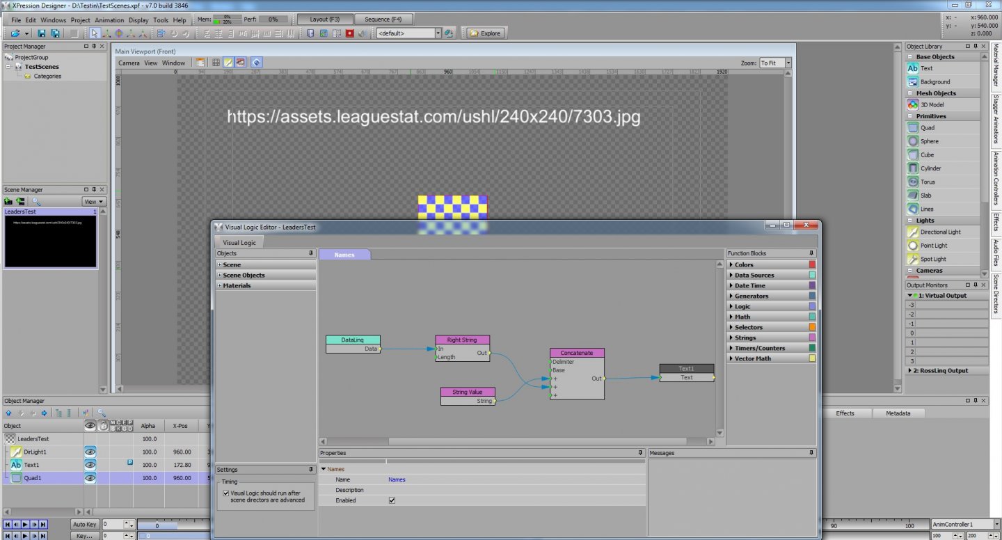

    Through Visual logic I have the link that I want. Now can I use a text object to fetch in image for a quad object?

    @garner Sorry I am a little slow on this. I guess I am not sure where I would put the the actual text from text 1 into this script. The picture is what I have populating now.
