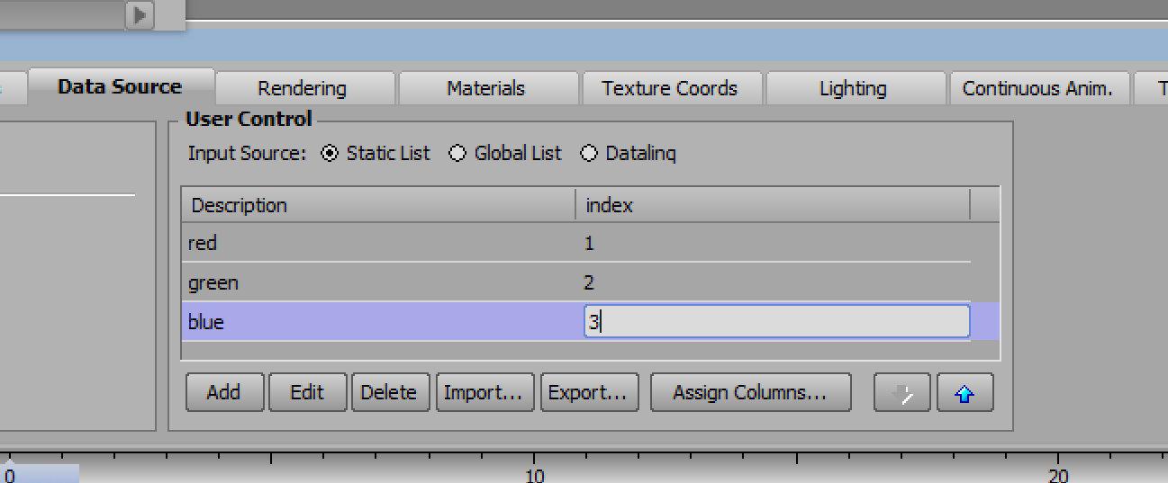

  • 5.  RE: How to get index of a user input combobox selection with a script
    Posted 07-04-2019 00:45
    you can set up columns that will assign a value to an index that can then be applied to a hidden text field. This can then be extracted and used in scripting. Scene.GetObjectByName ("Index1", index1) and used as a value in scripting. Will this help?
  • 6.  RE: How to get index of a user input combobox selection with a script
    Posted 07-04-2019 21:11
    Just tried it and it works perfectly. Awesome. Thanks a lot Malcom, I greatly appreciate the help!
