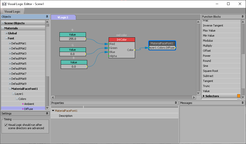

    Hello Frederick,
    You can see the material name that is assigned to a font from the "edit material" button in the scene fonts settings.
    You can change the default material name so it will be easier to retrieve.
    Then you can access it directly with Engine.GetMaterialByName(...) function as you would do with a material from the library.
    Font materials can be manipulated with Visual Logic too :
    Here "MaterialFaceFont1" is the name of the material that was assigned to the font face
    Hope it helps

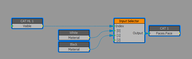

  • 4.  RE: Set Font Material
    Posted 08-06-2019 17:36
    There is an even easier option with visual logic.  The screen shot below is an excerpt from a logic tree controlling font color change in a highlight state.  CAT in this instance is short form for category.  Depending on your needs, this might be easier, and you can use pretty much anything to drive the input selector,.
