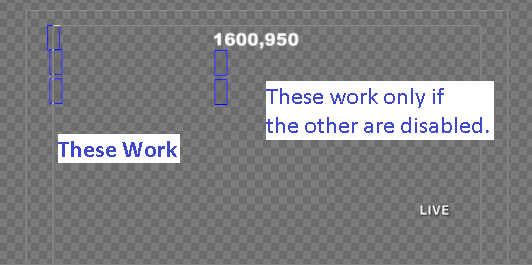

    Hi, I am attempting to set the location of two objects (one quad and one text) based on a pair of values in a spreadsheet using datalinq. I have two text objects that are linked to this value. Values are given as x,y pairs so for example: 1600,950.
    Everything worked perfectly until I tried to duplicate the code to position the text object as well. When I disable everything related to moving the quad it works. Otherwise, it doesn't even manage to set the the text boxes to the split values. I've spent over 4 hours trying to debug this, so hopefully someone can tell me what I'm doing wrong. Please let me know if I can do anything more to clarify.
    I've attached my code and a screen shot that might help.

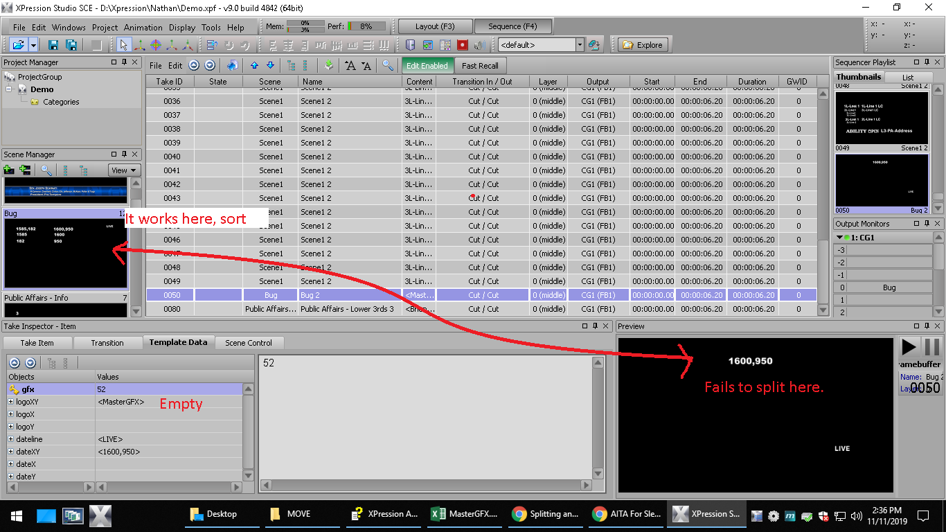

    I have this script in OnOnline and OnPreviewRender, and I have spent another few hours troubleshooting it. I haven't made any progress. Then I noticed this:

    Well, the issue seems to be with the datalinq. Your post gave me an idea. I did a quick test of just typing a number into the dateXY object and it worked just fine.
    I need this to populate from the datalinq though. Any thoughts?
    Edit: I am downloading your project now.
    Edit2: Confirmed that both versions, yours and mine function if the value is just typed in and not coming from a datalinq.
