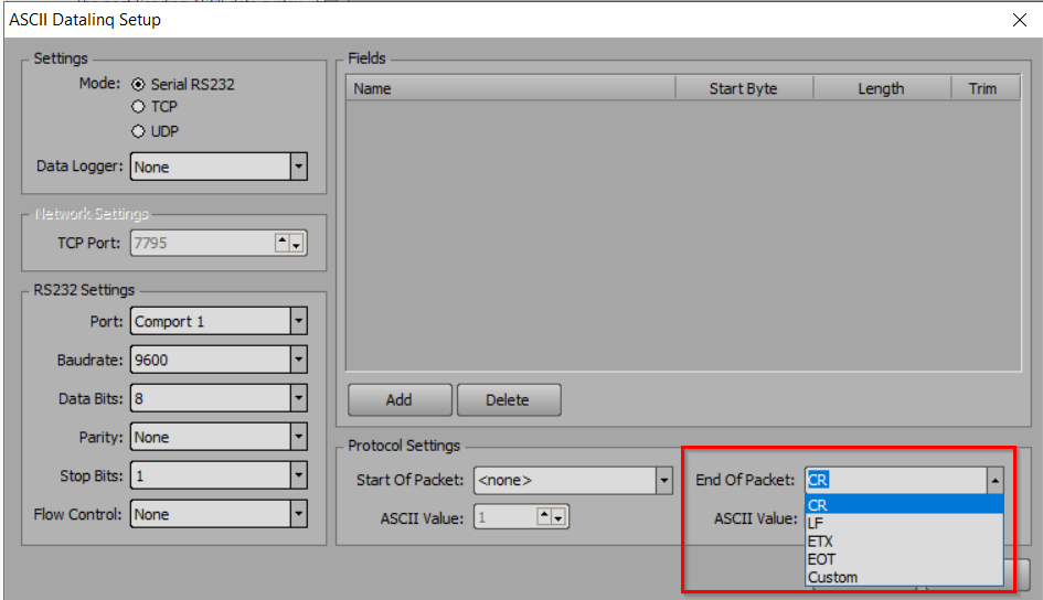

    Is there an and of line symbol expected such as "\CR\LF" ?
  • 7.  RE: Sending ASCII data syntax
    Posted 02-04-2020 09:50
    Hi Brian,
    Can you please advise on the end of line symbol ?

  • 9.  RE: Sending ASCII data syntax
    Posted 02-05-2020 19:01
    Thanks for clarifying!
